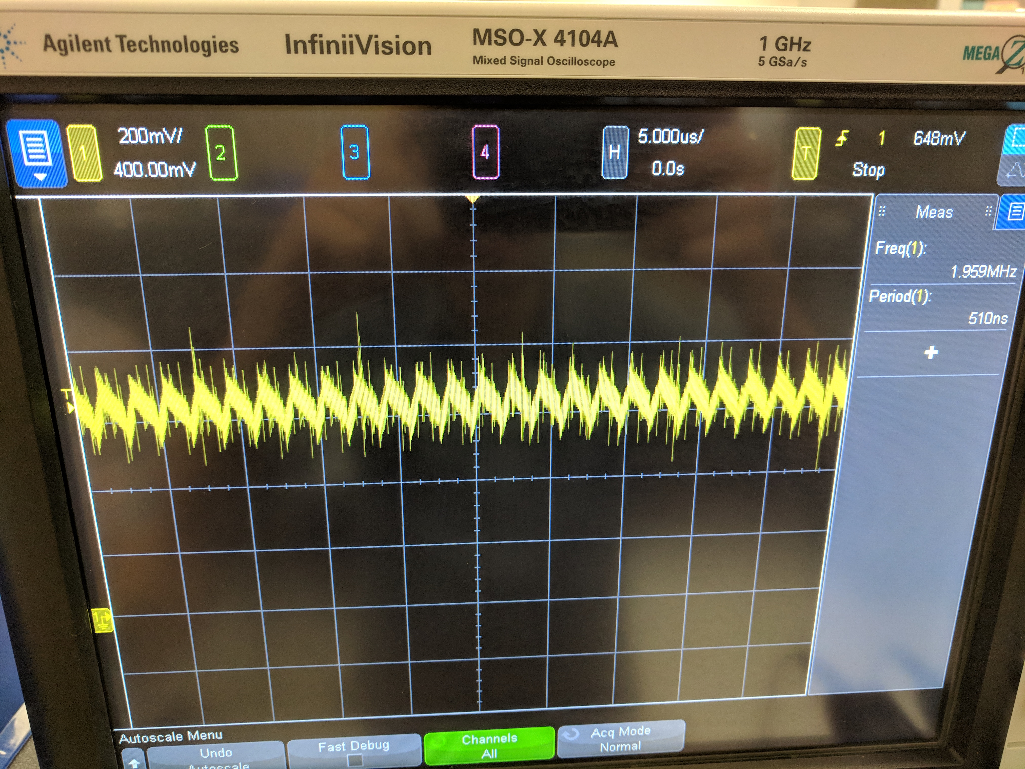

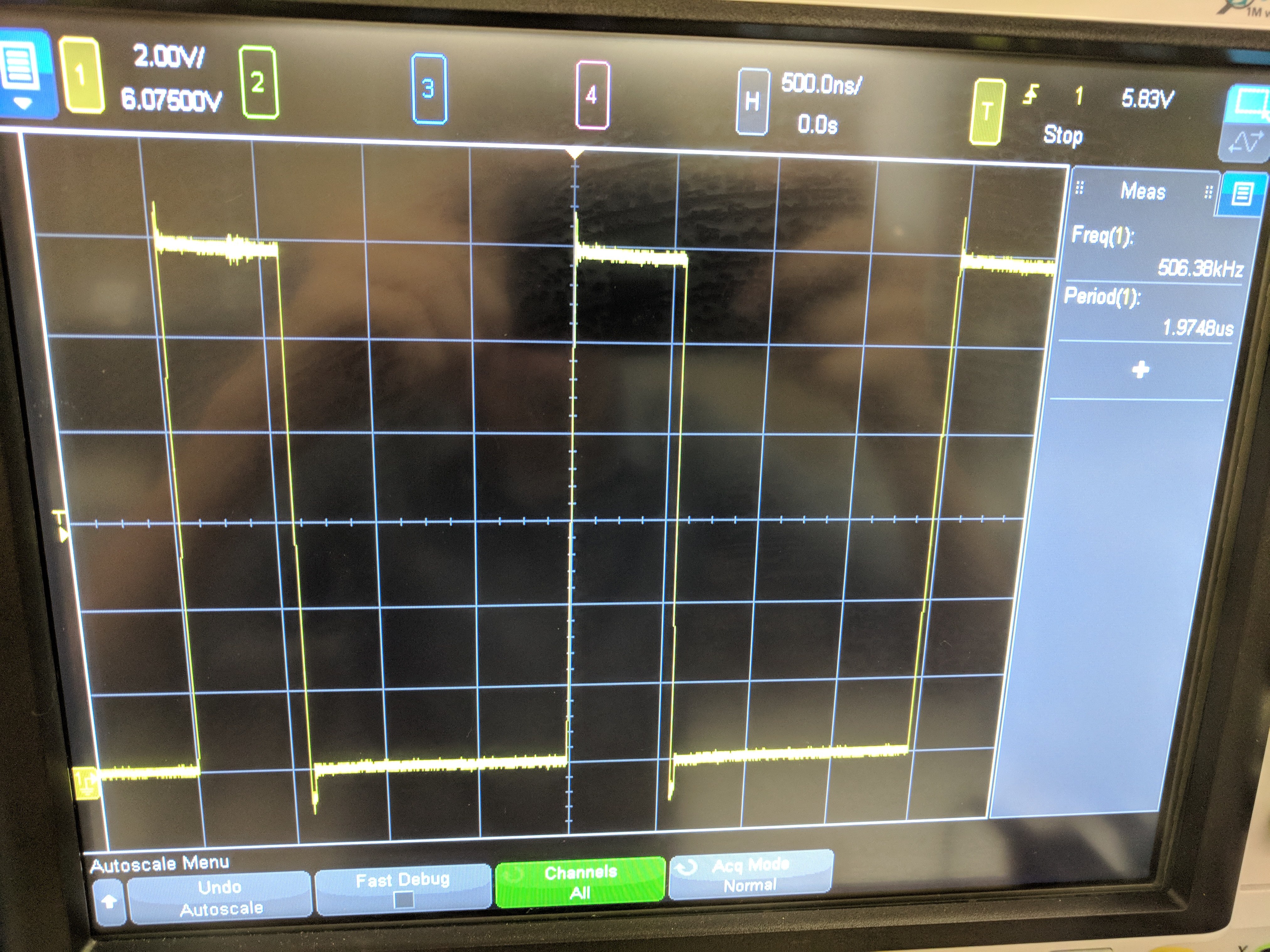

Hi Guys, I have an issue with the TPS53355 regulator and I was wondering if anyone has a suggestion for me.
I used the WEBENCH to design a 12V to 3.3V DC-DC converter. But now my output voltage is 3.5V. The reason is that the VFB is 0.634V instead of 0.6V. Any idea?
I have used this part before and never had this issue.
Here is the schematics:
