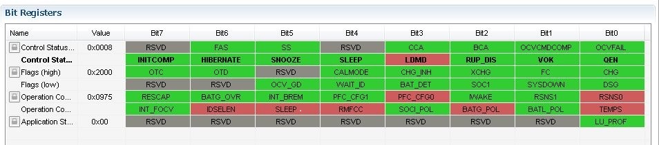

    Pls make sure the device is not in a sealed state. The SS flag if red will indicate it is sealed. Also, make sure the device has sufficient voltage, preferably greater than 3.5V before trying to program a gg file. Finally make sure that the contents of the files that you are trying to program on the device is within range otherwise you will get out of range messages.

    The customer confirmed what you pointed out.
    The SS flag of bqstudio was green.
    Also, when they measured the voltage they are supplying to the device, it was 3.7V.

    Where did you get that gg file from because i highly doubt you extract it using bqstudio other wise you would have been able to program the file back on the gauge. I tried programming the file on mine and there are an observations.
    - It appears you open and edited the file using MS excel. That is strictly forbidden as excel strips out the 0s of hex parameters that starts with them.
    -You need to edit the file using text editors like notepad to avoid running into such issues.
    -Also, make sure none of the parameters you modify exceed the limits that bqstudio allows. You will get an error in red at the bottom of bqstudio if that is the case.
