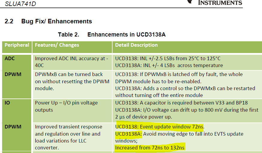

Could you help to confirm what is the correct value of the update window for LLC on UCD3138A64?
base on the UCD3138 programmer manual description, it show the value is 120ns as below.
but base on the migration guide, it show the value is 72ns(UCD3138) and 132ns(UCD3138A) as below.
please confirm UCD3138A64 is belong to UCD3138 series or UCD3138A series?
so I need your help to confirm which update window value is correct for UCD3138A64 in LLC topology. 72ns, 120ns or 132ns?
thanks!
