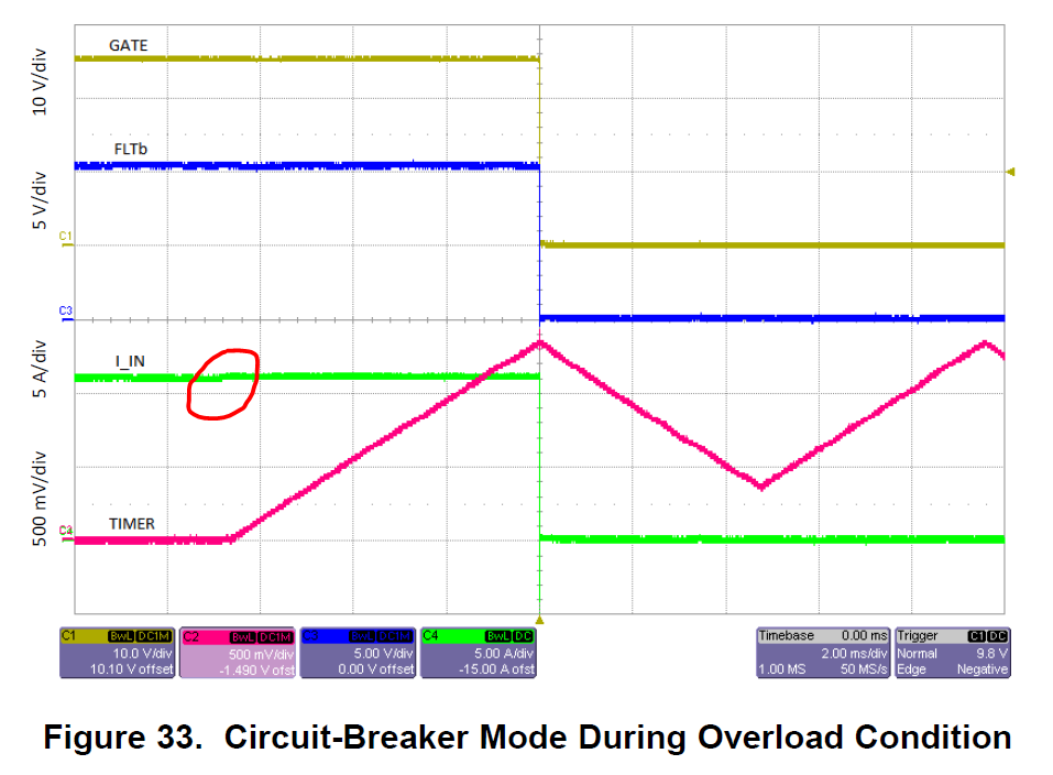

using TPS24751 EVB, I calculated current limit is 11A, but the efuse break on 10A, can you tell me why it is 10A not 11A.

    It is designed current limit value is 11A. Please share your test wavefroms (Vin, Iin, Vout, timer pin voltage) to look into.

      The input is a constant +12V input from power supply, the output is connected to a electrical load.
    if I manually adjusted eload's sink current to above 10A, the efuse will trip.
    On the Page #26 of data sheet, it says peak current limit is 11A, nominal current is 10A.
    Can you tell me how the 10A was calculated?

    The current limit threshold was calculated as ILIM = (minimum value of Current limit threshold-refer page7)/Rsense=22.5mV/2mOhm = 11A(approx.). So, the circuit allows nominal load currents of 10A safely without trip.
    Figure 33 in the datasheet was taken on EVM, where the circuit breaker timer starts operation just above 11A and then trips.
    Seems I got your test data through email. I will followup.
