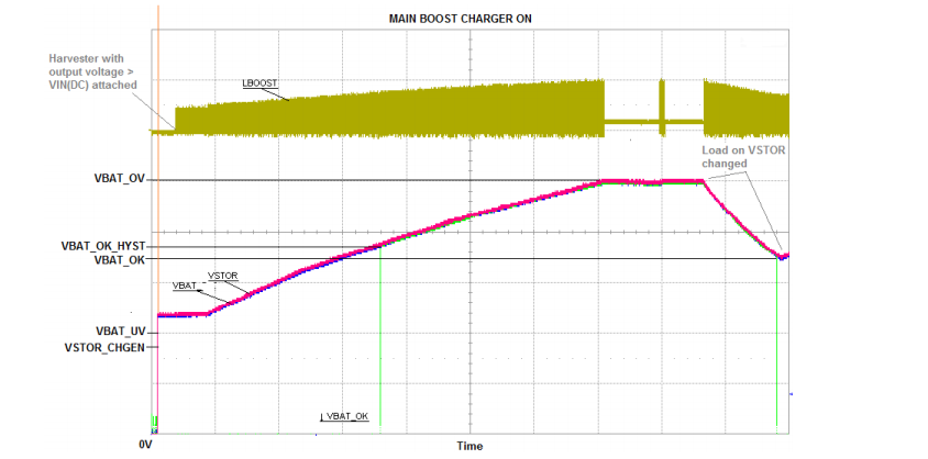

    To answer your question about "If VSTOR droops would it try to switch to VBATSEC?"
    According to the datasheet, if VSTOR is above VBAT_UV, the PFET between VSTOR and VBATSEC turns on. Please refer to the diagram below:-
    When the load on VSTOR changes, VSTOR and VBATSEC both tend to droop.
