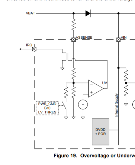

I don't see how adding a diode will help with reverse battery protection and exceeding the abs max value of -1V of the VSSENSE(1) pin. Can you explain this to me a bit more? I see there is an internal divider, are we relying on the external 20kOhms and the internal divider values to maintain the voltage at VSSENSE to <-1V during this condition.
  • Hi Julio,
