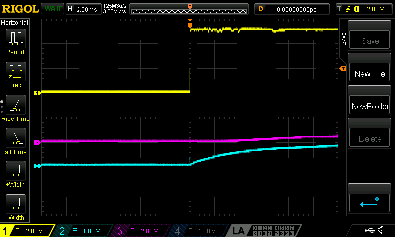

Some of our prototypes have entered a state where the BQ25120A will raise VSYS to 1.8V for a brief moment (spike lasts 10us), and then the voltage on VSYS rises only to 1V. These devices have previously booted successfully, and other devices are still working with the same software.

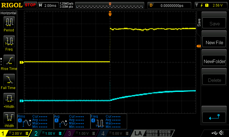

Yellow is VBUS from the USB. Blue is VSYS. The voltage spike is barely visible in the first image, see image two for a close up (note the differences in time scale).

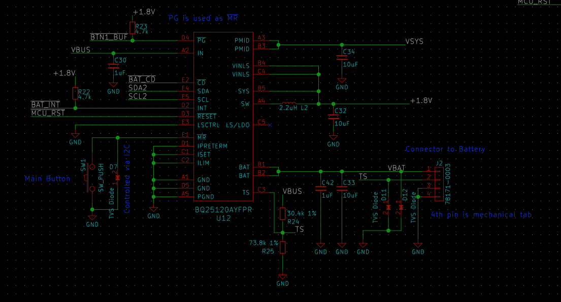

  • Here is the BQ25120a portion of the schematic:

  • Evan,
    Schematic looks okay. The puzzle here is why is VSYS trying to start back up really slow. What is the total capacitance on 1.8V rail?
    On the plot1, is battery connected? The VIN itself seems to chatter around 5.5-5.6V if you look closely. That is close to the OVP threshold.
    Are you able to startup with a DC supply with voltage bumped down a bit?
    On the /MR, since the default for the BQ25120A is to go to hiZ Mode, you wont see it trying to restart. If that bit was set to go to Ship Mode, then it will shut down.

    The battery is not connected. I took a closer look at VIN and it looks like the highest peak while it's ringing reaches 5.6, then stabilizes at around 5.1V. I will attempt to boot the device directly from a controlled power supply.
    Here is a plot with VBUS, VSYS, and PMID:
    Yellow: VBUS
    Pink: PMID
    Blue: VSYS
    PMID rises to ~750mV, but no further.
  • Evan,
    You will need to install a battery or a powersupply on the BAT pin so that /MR can function. /MR is pulled up to VBAT internally.

  • Hi Gautham,
    I have tried all of this with a battery. When a battery is connected VSYS only rises to ~100mV.
