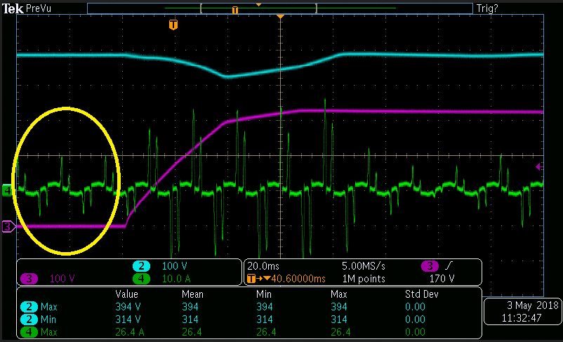

  I have a question is about UCC28950 soft start function , The enable pin  which from Pull up threshold (3.6V) to SS clamp voltage(4.65V), the UCC28950 will fast pull up the output voltage to design value 325Vdc , and the input current will clamp with cycle by cycle limit .The enable function show as Fig-1.  I think the two questions as below:

The Fig-3 shows the input inrush current will make the input voltage down to input UVP protection occur, and it’s happen in output start up.

    I think the problem is with the PFC stage and not with the UCC28950 because the current spikes look like they are 10ms apart - this could be due to direct conduction from the input of the PFC stage to its output. If the output falls below the peak of line voltage then you get uncontrolled current flow from input to output for that part of the line cycle when Vin is greater than Vout. Test this by seeing if the current spikes happen when Vac is greater or equal to Vout.
    The fast pull up feature cannot be disabled and in any case it happens after the soft start ramp has completed.
    Can you increase the UCC28950 soft-start time - try to double the capacitor and see if the inrush becomes less of a problem.
    Slowing the soft start will reduce the transient load on the PFC stage.
    Please note that the UCC28070 has an enhanced transient response (sect 7.3.11 in the Data Sheet). This should prevent the output voltage of the PFC stage getting so low but this feature is disabled during the PFC stage soft start. Can you use the SS/EN pin of the UCC28950 to delay its start-up until after the UCC28070 has come out of its soft start process ?

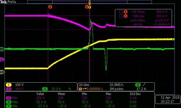

          I see the duty will increase in soft start , the duty will be maximum in soft start function , and the waveform as below:
    CH2:Main transformer V(for observed the duty variable)
    CH3:PSFB Vo
    CH4:PSFB input current
    I use DC source to be PSFB(UCC28950) source, and the DC source has the same status. The DC source input current spike shows below:

    I think the problem as below:
    1. The UCC28950 duty will be maximun in soft start function , I think the soft start should be soft to build output voltage.
        Could I make the duty in minimum (like burst mode duty) to finish the soft start function?  Could I set the duty in soft start?

    I also wonder why the current spikes are present before you start the UCC28950 - spikes in yellow circle below. If the UCC28950 is not turned on then there should be no current spikes.

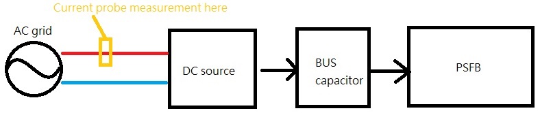

              The figure(yellow circle) as you see is the system power current , not from the PSFB.  My system turn on procedure as below:
    1) Turn on AC source
    2) Turn system power which provide all block start up , include UCC28070 start up .
    3) Turn on UCC28070 EN pin.
    4) When every block is good , I will turn UCC28950 SS/EN pin to build up Vo .
    Because I want show the problem is not from PFC , so I use the DC source to substitute PFC block.The block like below:

    1/ The input current to the PFC stage should be sinusoidal when it is loaded. At no load there should be virtually no current in the PFC stage input. The current spikes which I circled in yellow should not exist. Please show me where this measurement is being taken - a simple block diagram is ok.
    2/ If the SS/EN pin of the UCC28950 is held to 0V then the PSFB input current should be 0A. Again, the current spikes you show in first image of your last post should not be present.

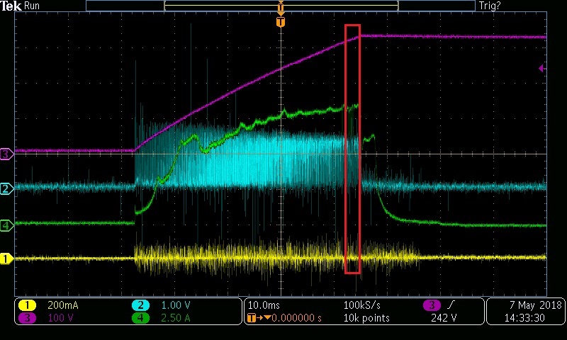

    3/ In SS, the duty cycle initially starts at a low value and is increased steadily at a rate set by the capacitance at the SS pin. Can you post a screenshot of the waveform at the CS pin during the SS ramp. Two horizontal scales please, one at 10ms per div and another at 20us per div
    4/ If you start the PSFB from a fixed DC source, then can you probe the PSFB input current. The PSFB load current, The PSFB Output voltage and the CS pin of the UCC28950.

    1) and 2)  The circle in yellow in Figure-1 which I measurement is the power line as Figure-2 block shows , and I have not use UCC28070 PFC block .I use a DC power source to substitute PFC problem.

    3) The SS pin and CS pin waveform as below:
    Css=4.7uF
    CH1:28950 SS pin
    CH2:28950 CS pin
    CH3:PSFB Vo
    CH4:PSFB Iin
    10ms per div
    Figure-1
    20us per div
    Figure-2
    4) I start the PSFB from a fixed DC source, and I probe the PSFB input current. The PSFB load current, The PSFB Output voltage and the CS pin of the UCC28950. The waveform as below:
    CH1:PSFB output current
    CH2:UCC28950 CS pin
    CH3:PSFB Vo
    10ms per div
    20us per div
