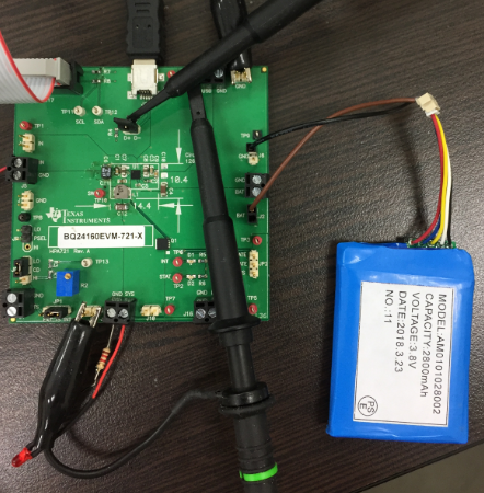

In my application I am using D+/D- detection and I set the D+/D- is short.
Battery =3.8V
My step is to connect the battery first and then connect the USB port.

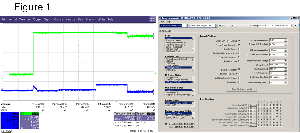

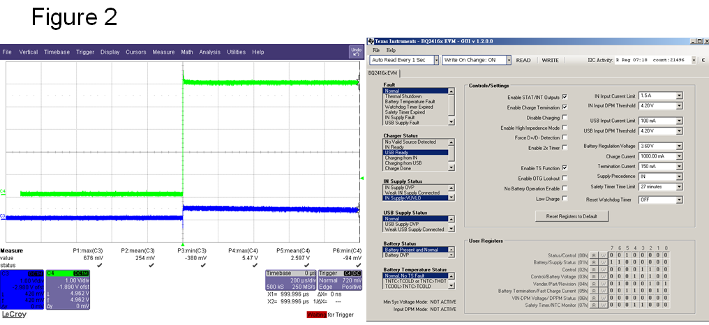

Then read BQ24160 Register 0X02
Sometimes USB input current limit is set to 1.5A
Sometimes USB input current limit is set to 0.1A
Is this a normal phenomenon?
