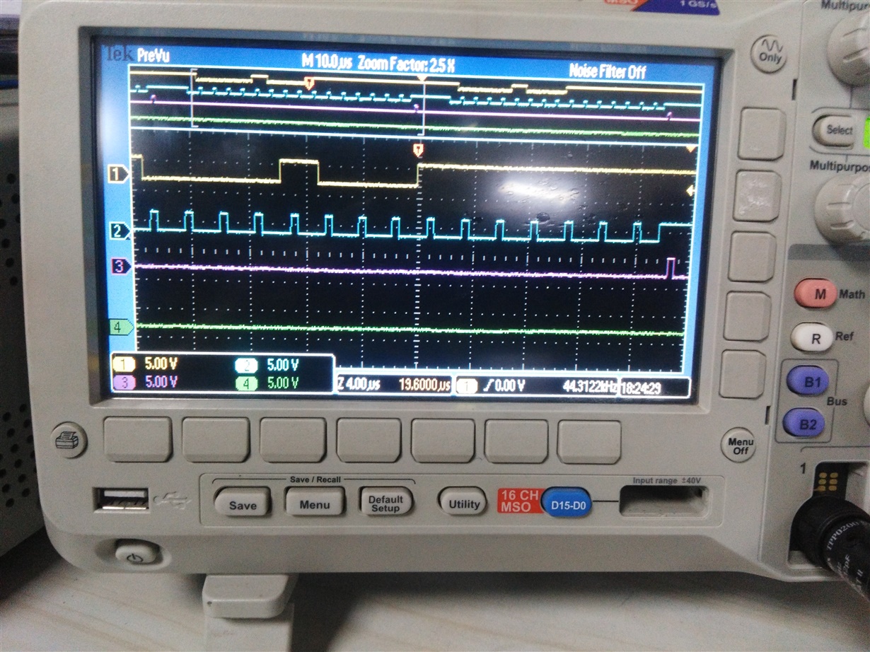

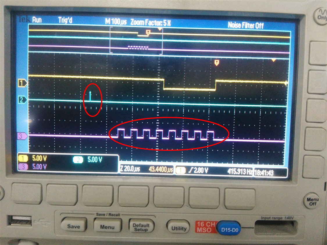

  • Hi Kenneth,
    I have used latch pin with GPIO or SS pin both but not succeeded.
    Can you please provide me sample example code for SPI.
    I am sending  you screen shot SIN / SCLK / LAT.
    Consider pin in different color on oscilloscope as follows-
    Yellow  ----  SCLK
    Blue     ------  SIN
    PINK    ------  LAT
    If you need any more information please let me know.Kindly provide SPI example code also.

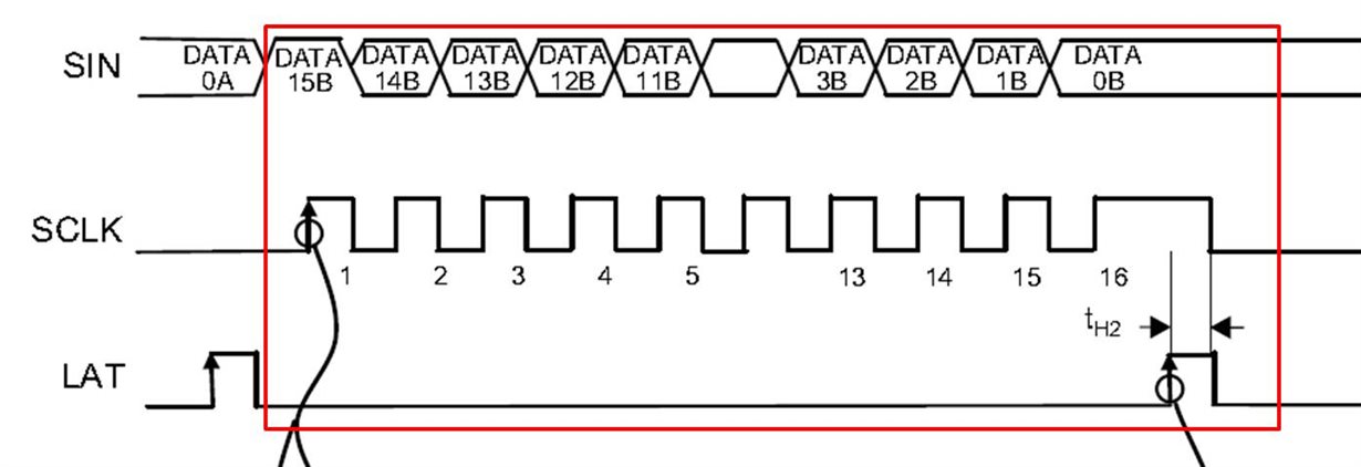

  • Hi, Twinkle,
    I'm wondering why your lat signal is in the front.
    As you can see from the following figure, the block in red line should be a whole data array. And the lat is added after 16 SCLK.
    I also attach the sample code of TLC59283 here for your reference, which should be similiar to TLC59291 code.
    6545.TLC59283_Sample Code.zip
    Please let me know if this solves your problem.
    Thanks.
    Kenneth

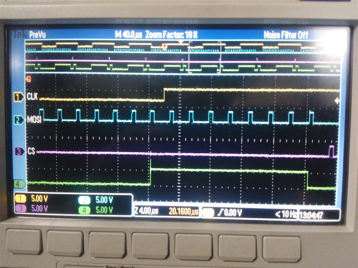

  • Hi Kenneth,
    I have given the LAT signal after the SIN as you said still i am not  getting the data on SOUT pins. the waveform of the SIN , SCLK and the LAT is attached in the figure.
    Figure Instructions
    Yellow --> SIN
    Blue ---> LAT
    pink--> SCLK
    Thanks.
    Twinkle
  • Hi, Twinkle,
    It seems your latch is still in the front and the SCLK is still 8, not 16.
    Would you help to check?
    Thanks.
    Kenneth

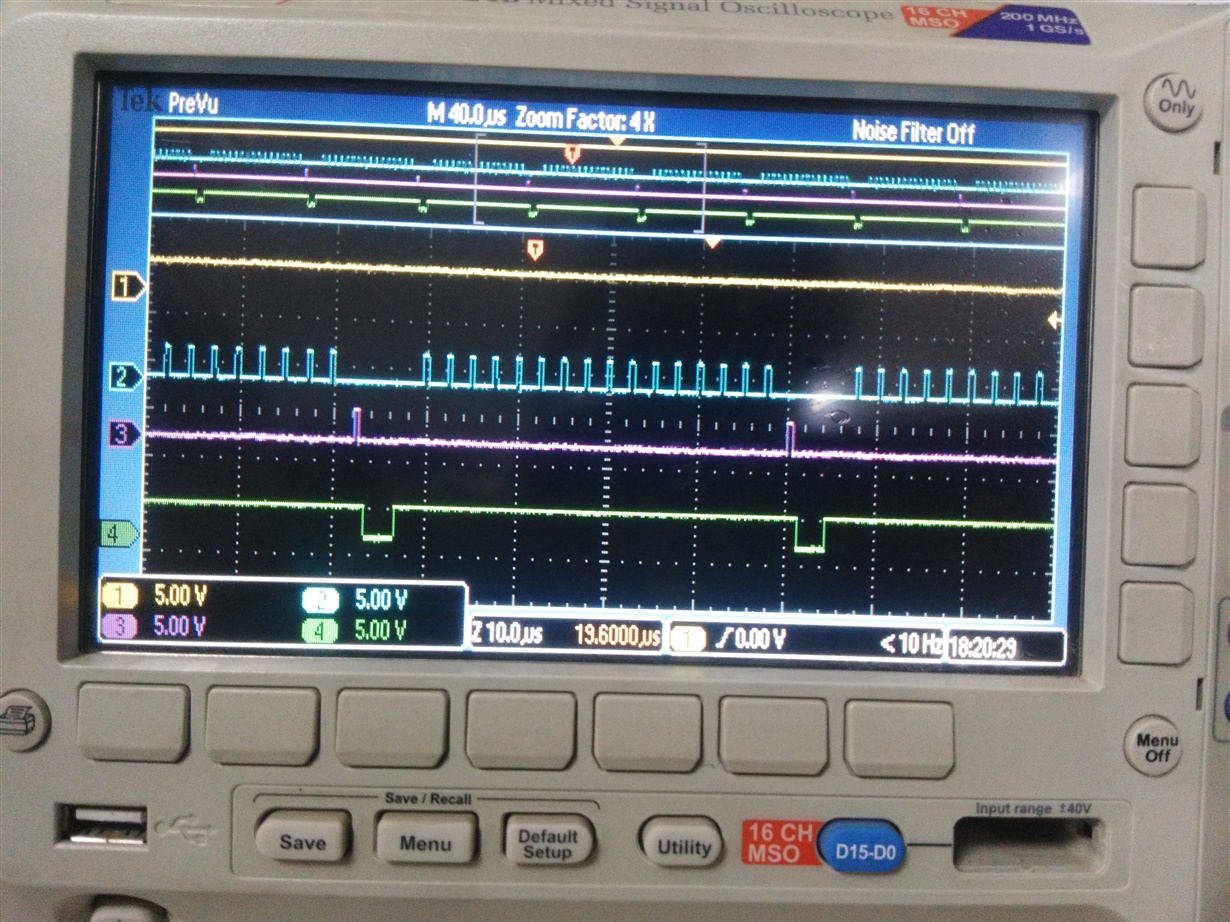

  • Hi,Kenneth,
    I am sending the control data too before output on /off data .
    At SCLK =1 I am sending control data
    At SCLK=0 I am sending the ON/OFF data
    but still i am not getting any output on SOUT pins .  I am attaching wave from for both control data latch and output on off data latch .
    and can you please tell me what should be the blank mode  and blank pin value for getting  the outputs on the SOUT pins.
    The wave from for control data is
    Image Description:
    Yellow --> SIN
    Blue -->SCLK
    Pink--> LAT
    The wave form of ON/OFF Data is
    Image Description:
    Yellow --> SIN
    Blue -->SCLK
    Pink--> LAT
    Green--> Blank
    Thanks.
    Twinkle

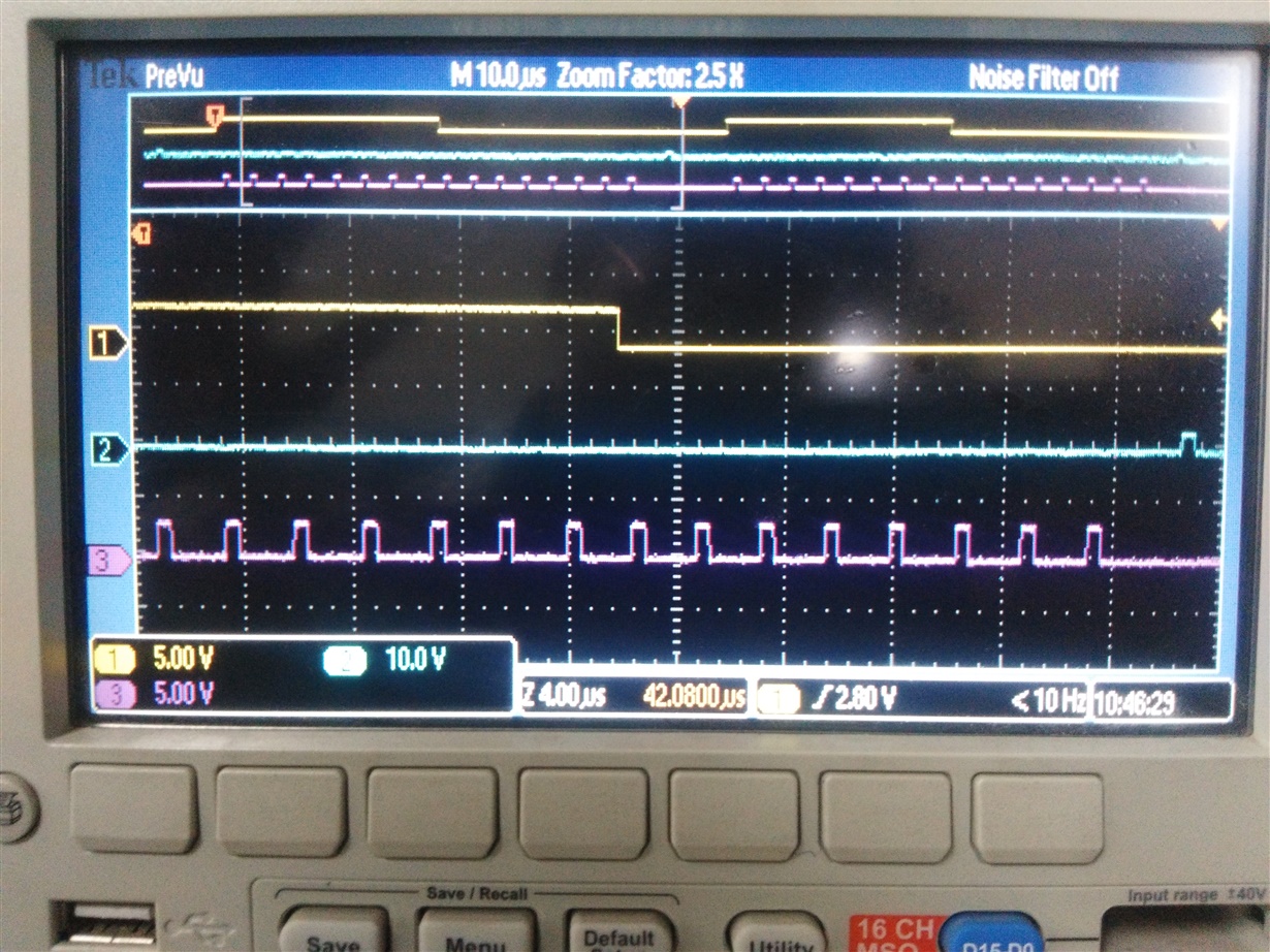

  • Hi, Kenneth,
    No, I am getting output on SOUT pin. but there is no output on OUT0-OUT15 pins. whereas No matter how i configure the blank mode i am not getting anything on OUT0-OUT15 pins .
    I am attaching the waveform of SIN, SCLK, LAT and SOUT pins .  I have sent this ( 0b0000000011111111) data on SIN pin .
    image Discription
    Yellow--> SIN
    Blue --> SCLK
    pink --> LAT
    Green --> SOUT
    can you please tell me what i am doing wrong .
    Thanks.
    Twinkle
  • Hi, Twinkle,
    Please try the following steps to quick test the OUT ON/OFF function:
    1. After power on, control data latch Bit[9] is default 0, which is SOUT mode, and if BLANK pin is set as HIGH, it works as 16ch device, if BLANK pin is LOW it works as 8ch device. Please make sure you choose correct ch.
    2. From your former information, you're using 16 ch, so you need to set BLANK high after power on.
    3. Send 16 bit ON/OFF data and after latch signal, the output should work as you expect.
    Please send me your waveform of the above steps for SIN SCLK LAT and BLANK if it still not works.
    Thanks.
    Kenneth

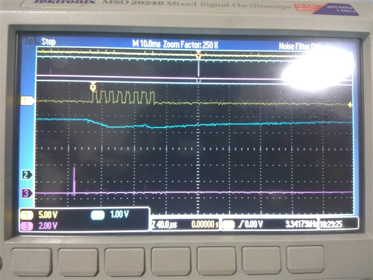

    1. The Output which we send for the OUT pins(OUT0- OUT15) of the IC TLC59291 does not remain constant.
    2. Their is huge voltage drop form 2.8V to 0.5V without any change in code, this voltage drop occurs.
    Looking forward in anticipation for your support.
    Thank You,
    Kind Regard,
    Twinkle
  • Hi, Twinkle,
    Currently we don't have software resource to provide SPI code.
    But since it's 16 bit data, there should not be big difference to use SPI and you can use an I/O or CS of SPI to senerate LAT signal.
    How do you test the current? And where do you test for the voltage drop? Did you test the OUT voltage?
    Thanks.
    Kenneth
