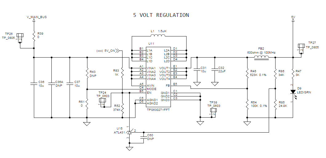

We are using the TPS63027 family of regulators for 3.3V & 5.0V regulation.  Out of 15 Limited Production Power CCAs, I have what appears to be two part failures.  I created a fishbone to help in the analysis.  My analysis is not complete yet.  I want to know if I can send the failed parts back to TI for analysis if final testing/analysis points to bad parts?

    Could you share the schematic and layout ? and the operating conditions : Vin, Vout. Iout?

    Failure is being defined as Vout* voltage climbing to 5.95V when the feedback circuit was set to 5.0V.  (It behaving as if it has no feedback path to regulate the Vout)  The failures were detected at 1st power on...no hot plug in and VinA* is isolated from any potential input spikes due to front end flyback power regulator circuit.  Additionally, output circuit was verified with no voltage spikes.  The attached circuit design has been running since December 2017 without a part failure.  It has been temperature tested over a 3-day cycle as part of our product test.  Schematic is below:

    I don't find any obvious issues on the schematic, could you share the layout?
    What is the Vin range and the load profile?

    After reviewing the schematic and layout, I could not find issues there. Moreover you confirm there is not hot plug in that could have damaged your device.
    However, since the output voltage is going up to 5.95V, instead of regulating to 5V, there could be an open contact on FB.(eg. soldering issue and the FB voltage is too low. If replaced with a good Unit the application will work again if the soldering is ok).
    Have you done a x -ray to check soldering on the FB pin and the resistor divider on the failing board before replacing by a good unit?
