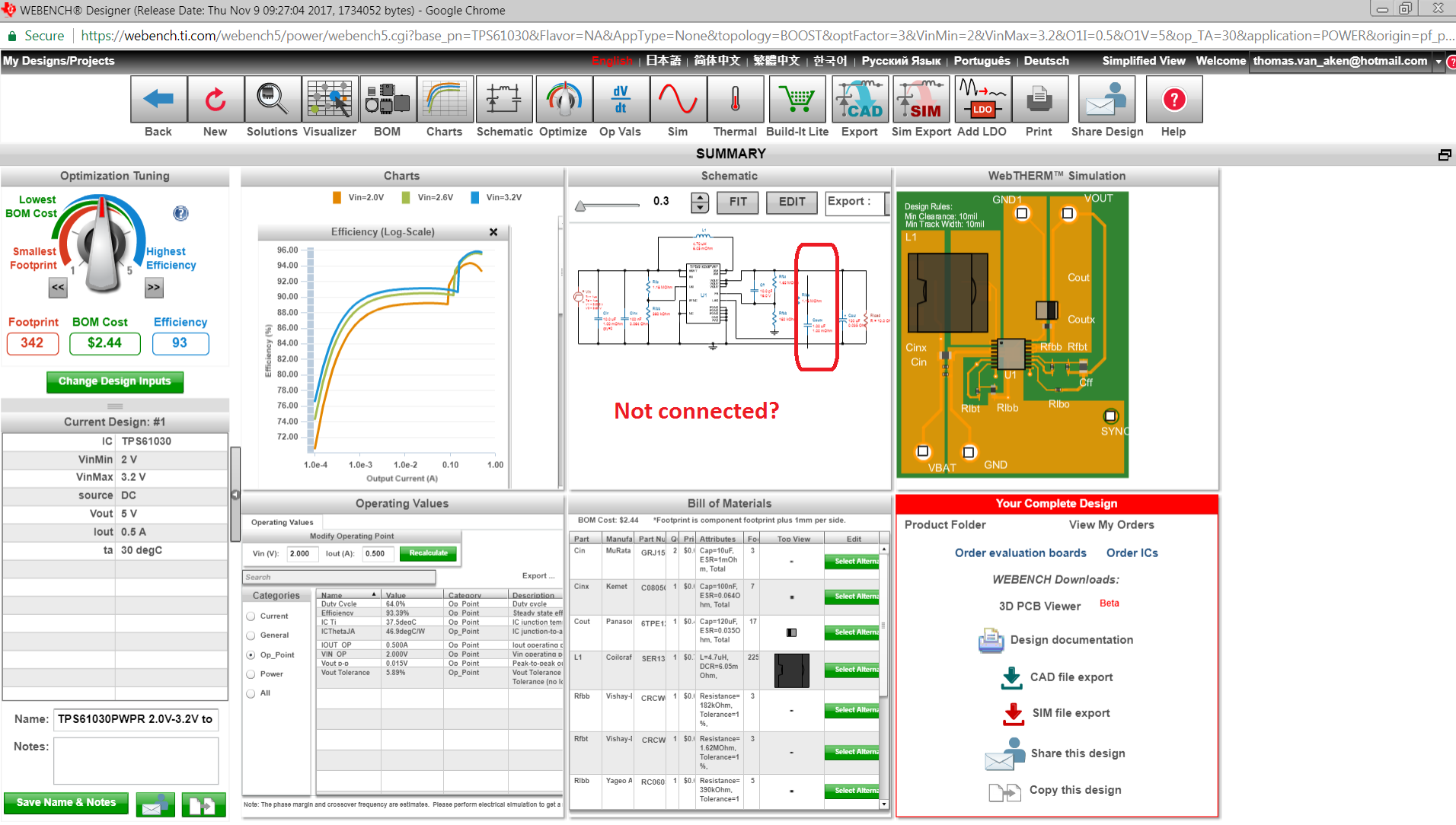

The simulation ans schematic generation of the TPS61030 and 2 act super strange. A cap is unconnected and the simulation is totally wrong when i run it with initial values.

    See the three following pictures:
    1) setup
    2) automatically generated schematic has the output cap disconnected

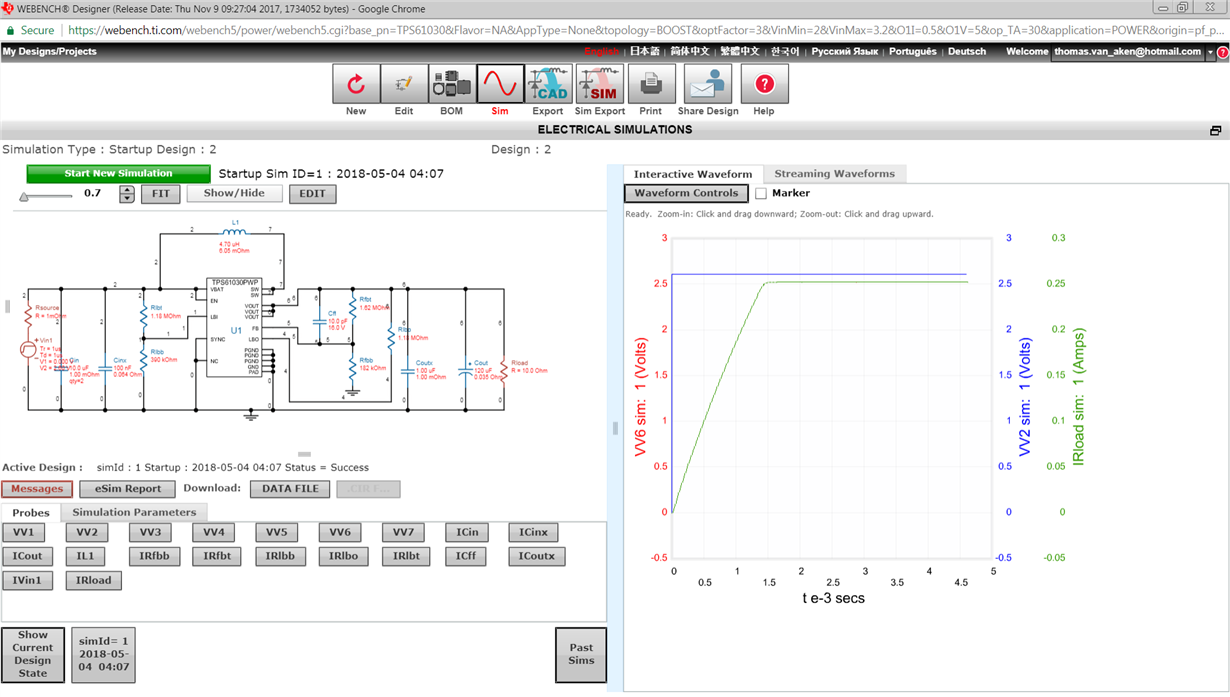

    3) connect cap and simulate.

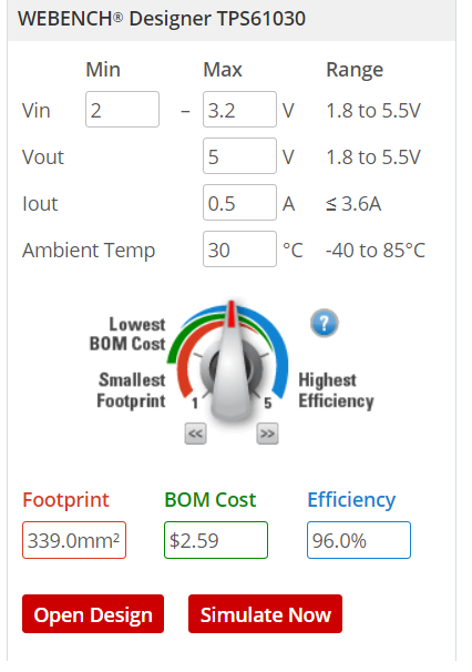

    I always have this, even with standard setup values.
    The output current and voltage is /2 vs what I need.

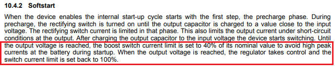

    The issue of broken output capacitor is resolved now but you will see the latest updates on ti.com in our next release.
    For the case Vinmin:2 ; Vinmax:3.2 ; Vout:5 ; Iout:0.5, the current limit is being hit. The device cannot start at full load initially due to lower current limit during startup. FYI the below image for more information on current limit.

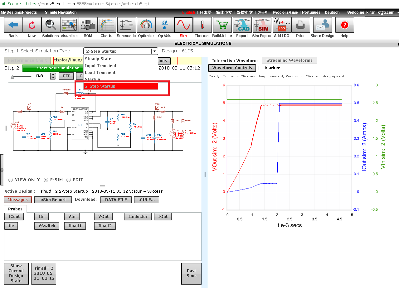

    We have an alternate testbench called 2-Step startup where initially low load is pulled until Vout is settled.
    Below is the snapshot for your reference.

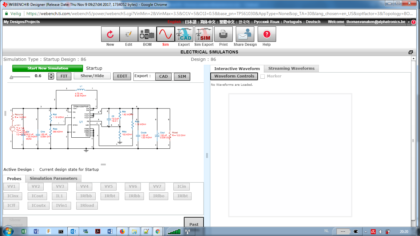

  • Dear
    I cannot select anything (it is only startup), when i try it on the site the output cap is still not connected.

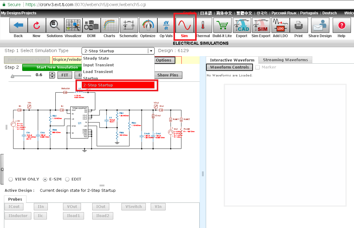

  • Hi Thomas,
    The release is yet to happen. you will be able to see the latest updates by this weekend.
    You cannot run any other testbench other than startup once you edit the schematic.
    To check all the testbenchs, please follow the below procedure.
    1. Once you create the design,first click on "Sim tab" where you can run all the testbenches as highlighted below.
