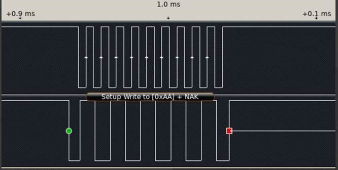

By analyzing the problem, we see that the fuel gauge does not respond to its I2C device address  0xAA. We see a NACK on the bus. (see image below)
The LDO voltage of the fuel gauge is not 1V8, but 0.5V. But when I measure a second time, it is 1V8 and everything works. Or I made a short during measuring, or the fuel gauge suddenly activates during measurement.

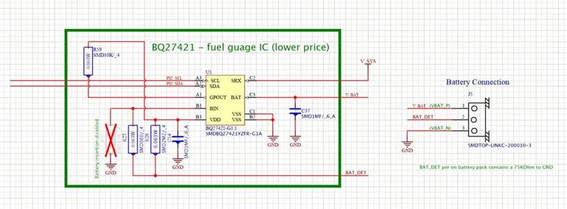

    • In our schematic, GPOUT is only connected with a pull-up resistor to VDD.
Schematic:
As far as I know, we do not send I2C commands to put the fuel gauge into SHUTDOWN mode.

  • hi Davy
    -ESD is the known cause of this issue.
    -No, you have to have the gpout pin connected to the gpio of hour host to be able to toggle the gpout pin in the event of shutdown. The data sheet has that pointed out.
    -ESD exposure like i mentioned earlier.
    -No

  • Hello Davy,
    To echo Onyx, are you able to take one of the units with the VDD low and toggle the GPOUT pin without the pull-up resistor?
    You just need to pull it high and then remove the pull-up voltage.
    Probe VDD when you are doing this to see if the VDD goes back up to 1.8V.
    Thanks!

    Conclusion:
    1) With current schematic, the only solution is to remove and re-insert the battery.
    2) In future redesign, we will change the schematic so we can drive the gpio pin.
    Thanks for the information
