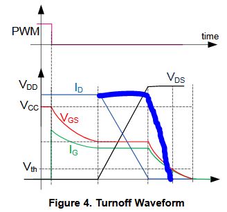

I think that there is a little error in the UCC27531 datasheet and I've been thinking about the issue for a while. In the figure 4, the MOSFET turn off is represented like:
But, as it is an inductive charge for the MOSFET it should be:
I hope it helps.
