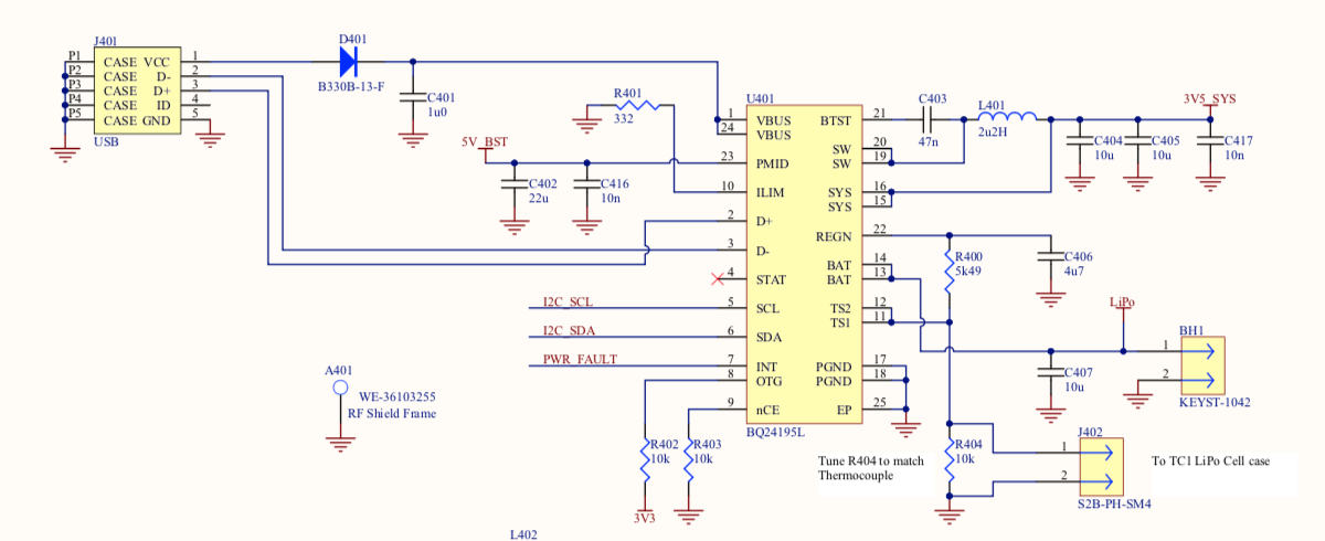

  • Hi Steven,
    Can you tell more about your setup? What do you have connected to the BAT, SYS, and BUS pins?
    Also, could you include an oscilloscope capture of the waveform you are seeing?

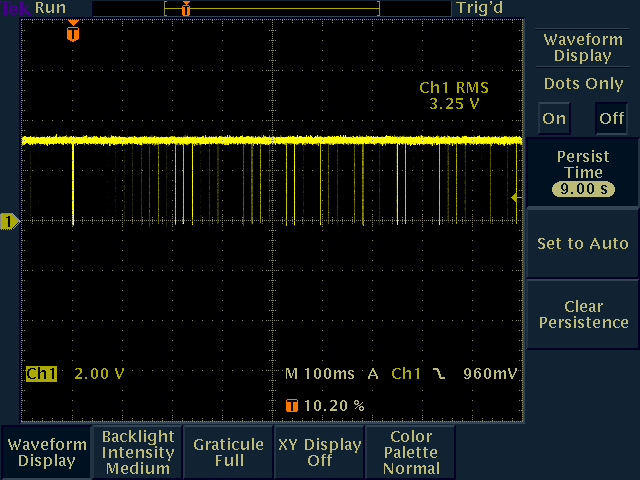

  • Thanks for the response. Took a little while for me to get back to this issue.
    As I think I mentioned, the registers are all pretty much default settings; doesn't matter what the interrupt mask is set to. When I unplug the charger (VBUS), one interrupt happens and the status is as you might expect. Wait for a bit and then plug back in, another interrupt and I see it's in fast charging mode. Once the battery is charged, then I get the repeated interrupts... they seem to slow down after a while to once a second or so, but at first they are pretty frequent.
    The schematic is attached, with the main difference being that D+ and D- are shorted together. LiPo is a 3v7 cell.
    The scope output is set up so that we can see the repeated interrupts. They are all clean, square, about 250 us wide.

  • Oh, I should have mentioned that the scope capture I sent shows this clearly with many, many interrupts happening after a change from fast charging to charge complete.
  • Hi Steven,
    Can you send me a scope shot of the BAT pin as well as the INT pin over a 50ms/DIV scale?
