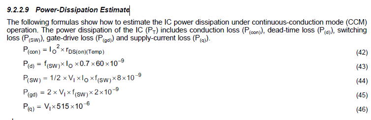

Whether the switching loss and loss in charging the gate given in page no 27 of the datasheet of tps54388-q1 , under the topic 9.2.2.9 Power-Dissipation Estimate is common for both high side and low side FET?
Please advice.

Yes the equations include both FETs.
