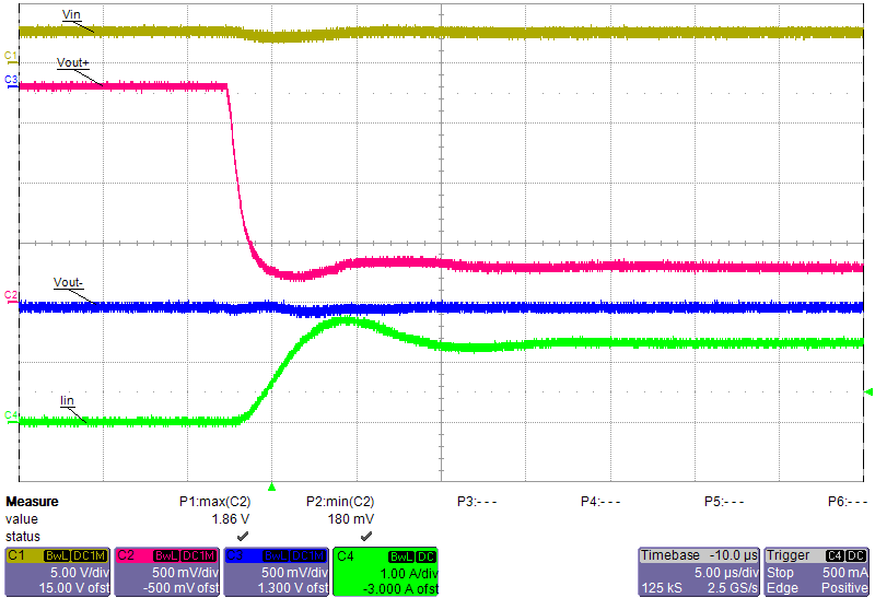

I would like to know LDO current limit operation.
Could you show me the behavior or waveform during current limit?

>Which LDO are you asking about, the positive one or negative?
Positive one.
>What is the concern with the current limit operation?
My customer says that output current is 3A at the moment during start up.
Kuramochi
Chris-san,
Thank you for your information.
3A current is inrush(120us).
They observe the current before output capacitor during startup.
Current limit cannot prevent inrush current because it is a moment.
Is it correct?
