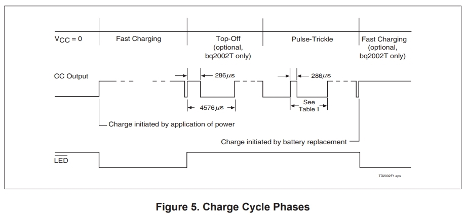

I have a simple question. The maximum charge time is configured by TM pin.
The timer is configured at three-level.(Low , Mid , High)    When is the start point of the maximum charge time?
Is it when CC output go to high at fast charging?
