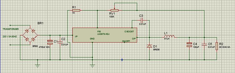

HI,
 i design 1.2 v to 36 vout and 5a power supply ....actually already design one circuit using ic lm2678adj...its working to without load am getting the voltage 1.2 v to 36v.but when i was connected to load rheostat (50 ohm and 5a ) output voltage and current totally drop at the time am getting 0.111 0r 0.223 v feedback also 0.231 etc...
any one please help me how did i get output....or design the circuit
Cin- 4700uf 63v
r1- 1k
r2 -100 k pot 10 turns 3 w
Cboost- 0.01uf
Cout -10uf 63v
inductor -47uh
didoe -sr506
