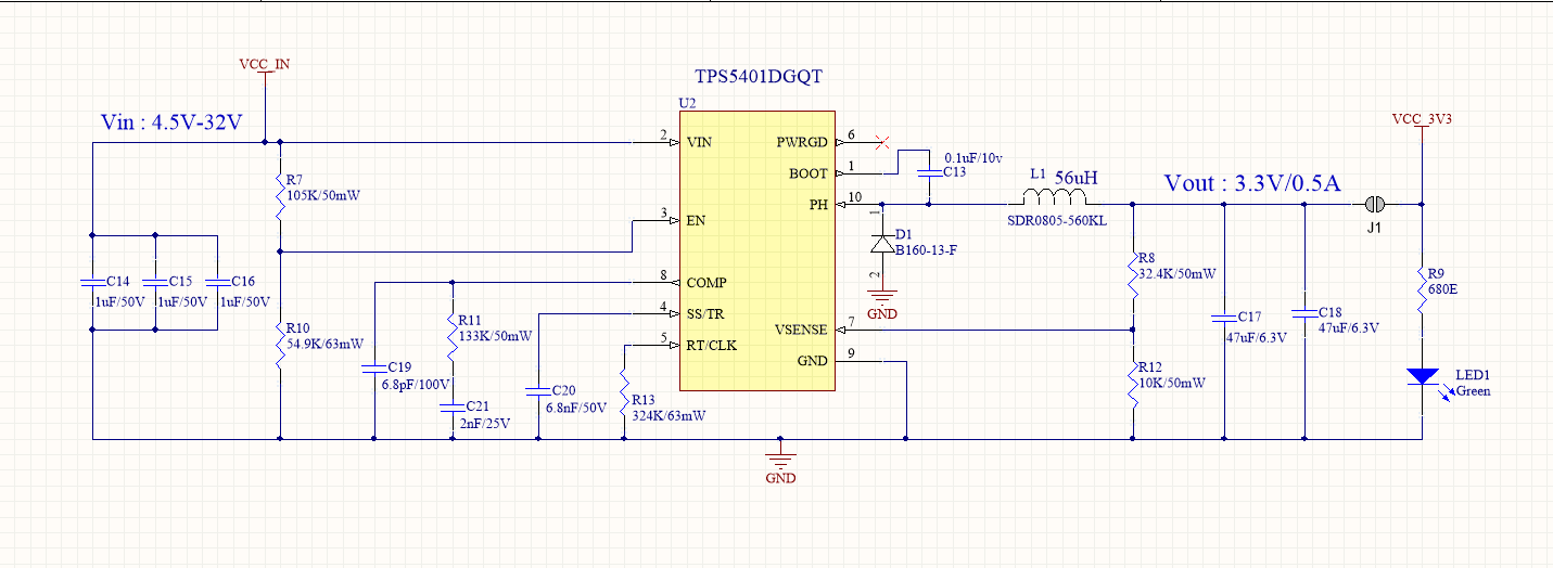

Please review the attached TPS5401 DC-DC converter design and please share your valuable comments on the same to improve the design,
I/p to the device is 4.5-32V and o/p is 3.3V/0.5A

Hi
please find the attached reference design from TI.
Regardswebench_design_4730282_21_257048457.pdf
