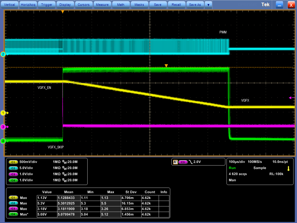

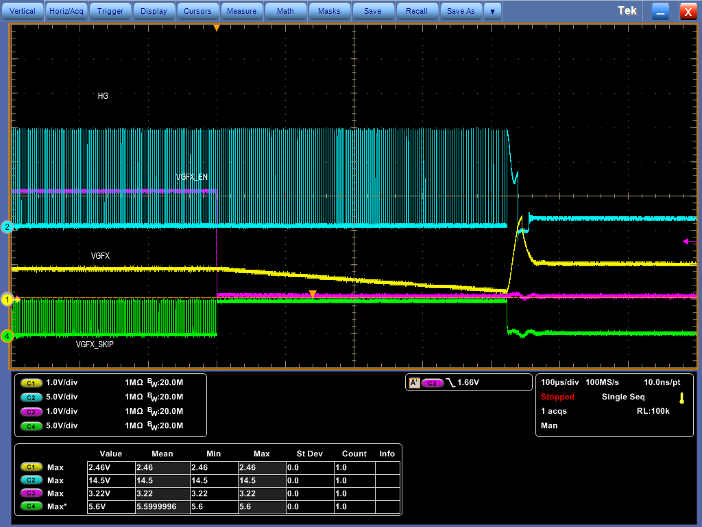

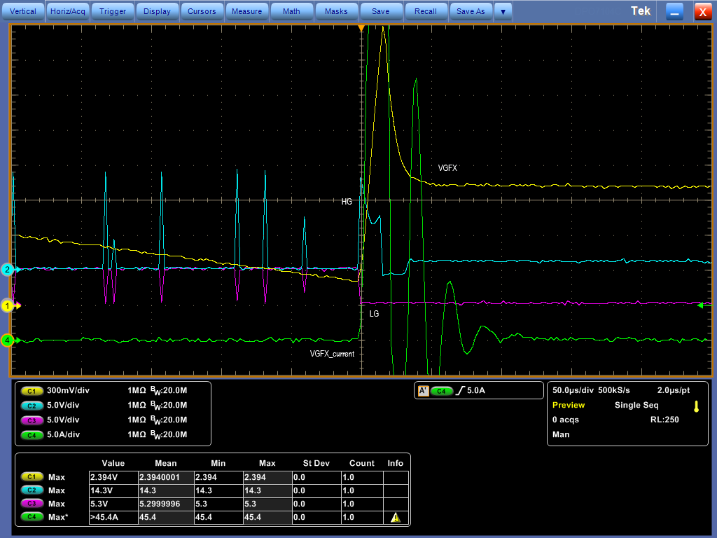

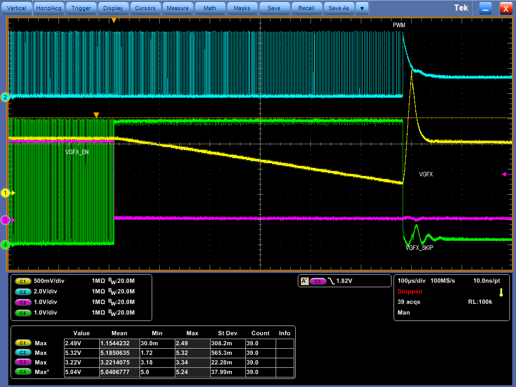

Hi Sir,
Our  Customer used the TPS59641 for CPU Vcore & VGFX power,
But Shutdown have Vout Skip to 2.xV damage VGFX pin,
Customer Schematic is copy by Intel.
Do you have any Suggest for this case?
Ch1=VGFX is Vout(+VGFX)
Ch2=HG is High Side Gate(VGFX_DRVH_TG)
Ch3=VGFX_EN is VR_ON(PS_ON)
Ch4=VGFX_SKIP is (VGFX_SKIP_N)
