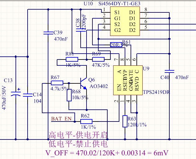

Part Number: TPS2419
Hi team,
customer using TPS2419 on their system, but they found when they input 12V on C pin, they could test 10V on A pin, and up to 20V on BYP pin. Nothing change when they pull up or pull down EN pin.
Could you please help to check this problem.
