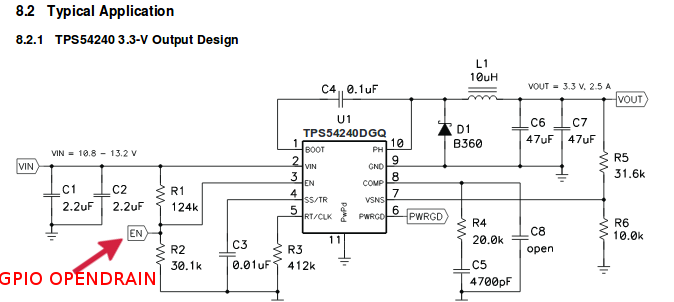

Hi we need to shutdown the TPS54240 when we want, could you teel me that if we use a 3.3v pin to control voltage on EN pin we could do that, somthing like this image, we use divisor to have 1.28v on that pin when MCU set hight.
