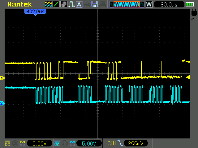

I am having difficulty reading any form of data from the Battery Management chip BQ34Z100-G1.  All data i read back is zero for some reason.
I am connected to a battery to try to read from the chip, but no luck.
I have purchased bq34z100EVM and also have no luck in reading from the device.
The commands i have tried are:
Voltage, Capacity, and Temperature.
Furthermore, for some strange reason the Capacity and Temerature have 3 bytes of data, I would like to confirm if this is possible.  the wave form is shown below.
I am not sure what I am doing wrong, any help in this matter would be much appreciated.

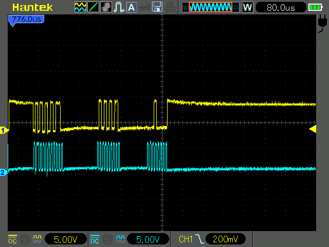

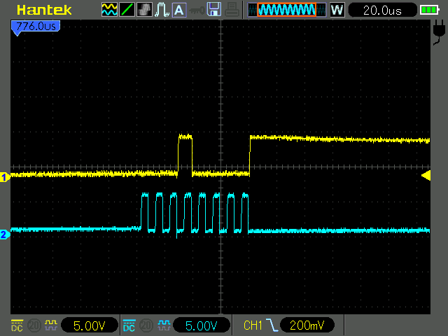

    I seemed to have been able to solve that issue, and now am faced with another issue.
    It seems that I can read from the device only one time.
    After I get say my voltage data, the bq34z100-g1 holds the data line and I am unsure how to free it.
    I have added my usual last read byte and I believe the stop is done appropriately.
    any clues would be very much helpful.
    Thank you
  • Hi Derick,
    What was the solution to your original problem?
    Regarding the second problem, It is not expected that the gauge will hold the clock line low indefinitely. Some clock stretching is expected occasionally, but it should eventually release it. One thing you can try is to drive both clock and data lines low with your MCU and see if it will release the bus.
