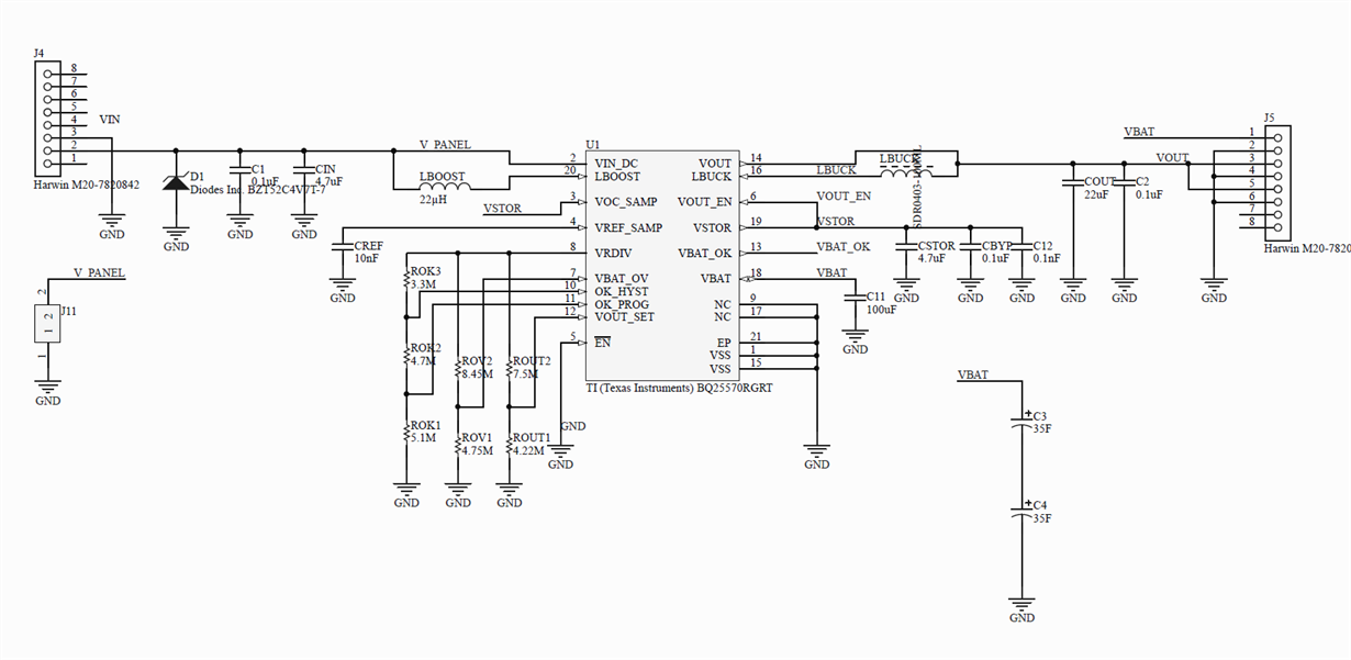

BQ25570: How to handle lipo or nimh battery
Part Number: BQ25570
I have made a board following this schematic inspired from the TI one and all is working fine. I'm recharging two supercap of 35F with a small solar panel. Now, i would like to know how to adapt this schematic in order to recharge a NiMh battery (or LiPo if posible) but as it is for outdoor application, i guess it is better to use NiMh.
If you have any ideas, feel free to share :)
Aurélien
