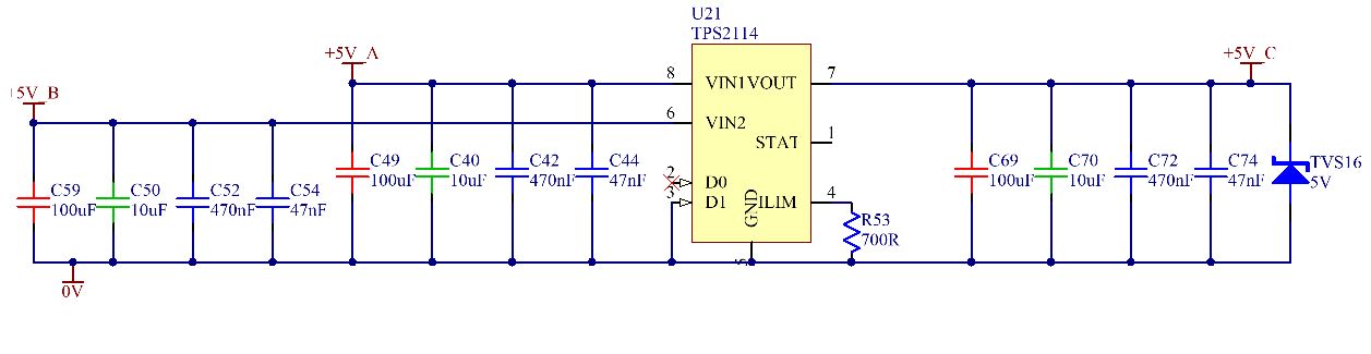

Hi, I hope someone can help me.
We use the TPS2114APW in several products to OR together two 5V supplies and provide current limiting. We’ve found that under certain circumstances the current limiting either doesn’t work at all or current limits at a much higher current.
We only see this problem sometimes when the input supplies are at a similar voltage and the output of the TPS2114 is suddenly loaded beyond the current limit. We don’t see this loss of current limit if one supply is 3V and the other is 5V for example, only when both are at 5V.
Thanks in advance
Gordon
  • Hi Gordon,
    When you say the current limit is not working, are you able to pass more current through the device than expected? Do you have any scope shots or data to show the problem you are seeing? Also, can you share your schematic so that I can see how the device is configured?

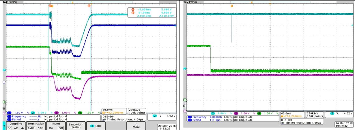

  • Hi Alek
    I have got some waveforms to look at. The circuit is that shown above. 5V_A and 5V_B are provided from bench supplies.

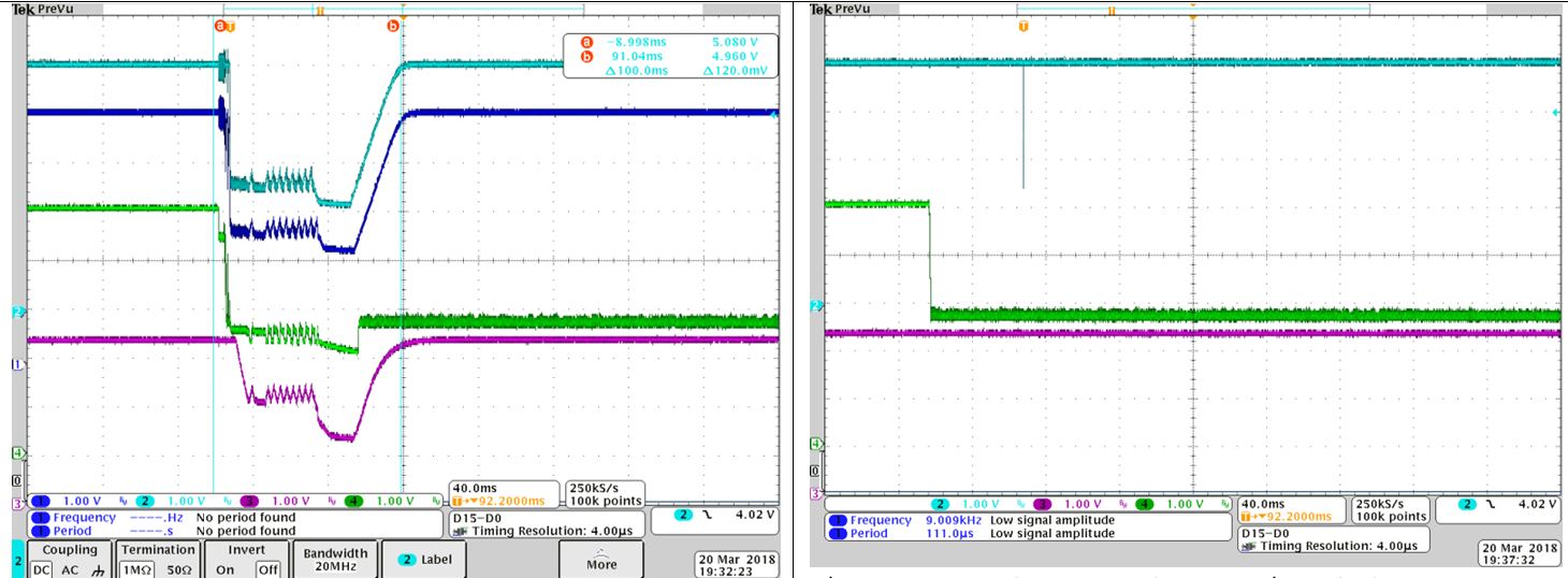

    The green trace in the first picture is the output from the TPS2114. It is suddenly loaded though not enough to collapse it completely. The blue traces show the voltages on the TPS2114 IN1 and IN2 inputs. Both inputs sag as they are current limited further upstream (circuit details not shown). This is the fault condition.
    The second picture shows what happens when IN1 is 5V and IN2 is 0V. The same load on the output of the TPS2114 is fine. The TPS2114 current limits as it should and the IN1 stays up.

  • Hi Gordon,
    Apologies for the delay in reply.
    This is pretty strange behavior, especially when the TPS2114 has no problem. It looks like the current load on IN1 causes a voltage drop, and then IN2 > IN1, so IN2 takes over for the output. Then IN1 recovers and it keeps switching back and forth. This is because both sources are 5V and even a small voltage drop can cause a switch in supply. Perhaps the current is not able to get high enough to trip the limit because both sources are switching before the current can reach the current limit.

  • Hi Alek,
    Why do you say the TPS2114 has no problem?
    I agree with your summary about the supplies switching back and forth but I'm thinking it might be that the TPS2114 current limit is disabled momentarily when switching between IN1 and IN2 and if the switching occurs repeatedly then there is no effective current limit at all.

  • Hi Gordon,
    My mistake, I misread the information you provided and thought the first scope shot was TPS2115. With both of them being TPS2114, I think your summary may be correct. To be sure, would you be able to check with IN1=5V and IN2=4.5V? That way we can confirm that it is not just both channels being powered, it is that both channels are the same voltage.
    Alek Kaknevicius
  • Hi Alek
    I have checked the TPS2114 with IN1 at 5V and IN2 at 4.5V and again with the opposite voltages on IN1 and IN2. The TPS2114 current limits perfectly according to the limits set by the current limiting resistor. Yet if I set both voltages the same I can get it to fault (not every time but often enough to observe).
