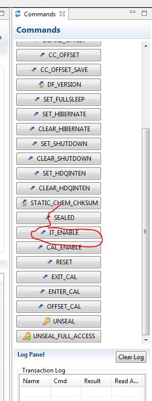

Milla,
There is the command window on the far right that has the IT enable button that will enable you send the command.
Alternatively, you can do so via the advanced comm window by typing the command in little endian, i.e 21 00

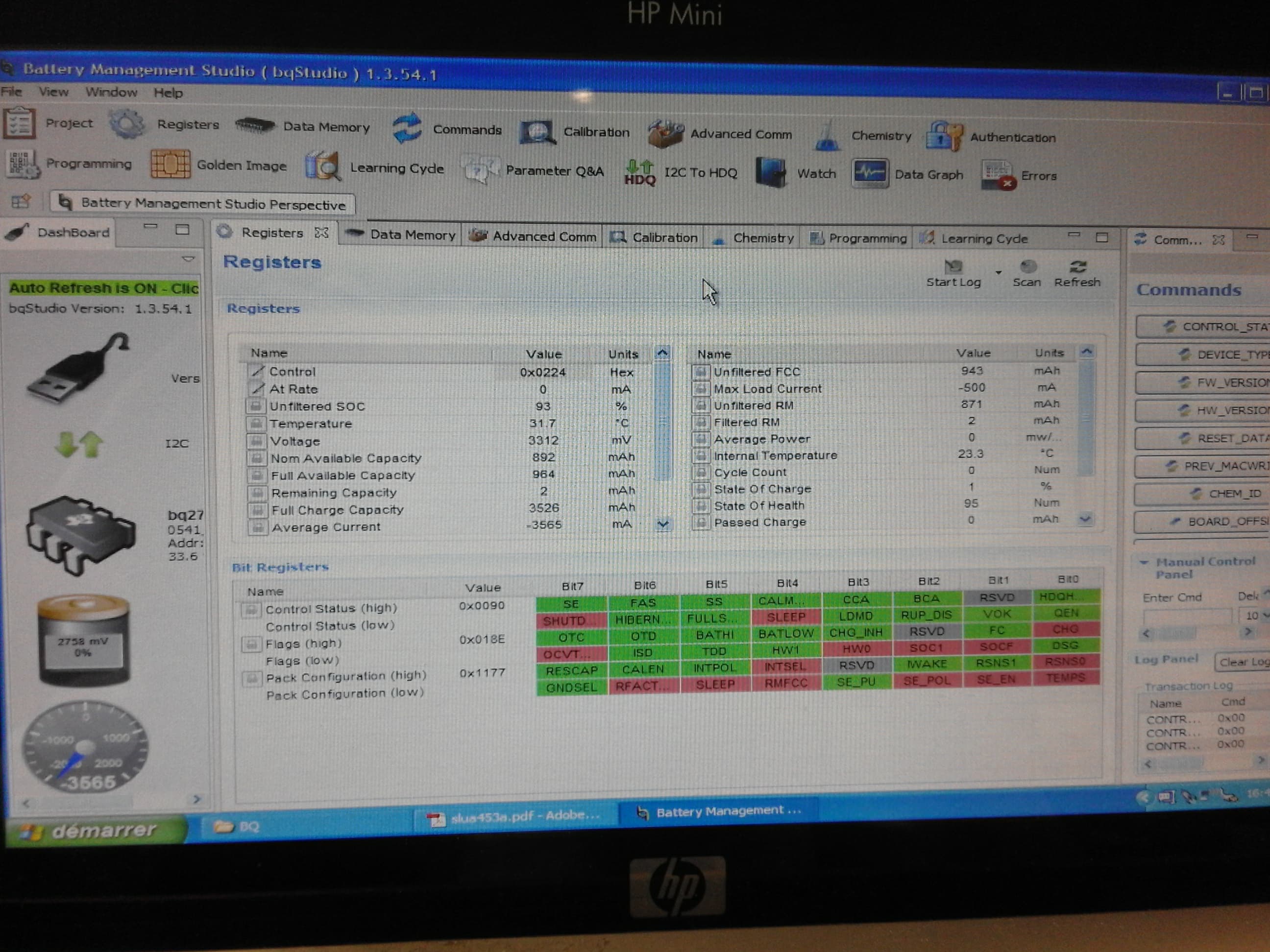

hey
-where is this command wondows?,whould you like to indicate it to me in the picture please
-i ll do the learning cycle by this way:
-desharge-wait 5h-it enable -charge-wait 2h-decharge-wait 5h-update statue:06-
is it right like that
-generate a golden image after that,i ll make it but tapping on create golden image,wright?
