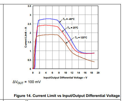

    there's no simple protection scheme in the TPS73801. It's more a complex SOA protection which depends not only on temperature, but also on load current and input to output differential voltage. Please have a look at figure 14 of datasheet:
    Datasheet also mentions, that the recommended maximum operating junction temperature is 125°C. So, the temperature shutdown will take place at a temperature above 125°C. But there's also manufacturing tolerances so that a sharp turn-on or turn-off threshold temperature for the thermal shutdown cannot be given.
    Allthough the datasheet specifies the maximum operating junction temperature as 125°C it's not recommended to run the regulator for long periods at such high temperatures because the life time can decrease. It's always wise to keep the junction temperature at a minimum by including enough headroom. The thermal shutdown should never be a substitute for a proper thermal design. It's like with the fire distinguisher: You want to have it, but you don't want to ever use it... :-)

    I confirmed Figure 14 that Kai posted.
    Customers use @ VIN = 12V.
    In this case, when the load is short-circuited, it seems to flow as much as 1.5 A (TA = 125 ° C.)Is it correct in understanding that such current does not actually flow?

  • Hi T,
    in a short circuit event when the output voltage becomes 0V, the input to output differential voltage will be 12V. According to figure 14 a short circuit current of 0.9A...1.5A will typically flow, depending on temperature. Assume it is 1.3A at 25°C temperature, then 15.6W will have to be dissipated in the TPS73801 for a short moment. This will make the chip heat up, of course, and within a fraction of second the short circuit current will decrease according to figure 14. At this moment the heat dissipation will also decrease because of the decreased short circuit current. If the TPS73801 cannot totally remove the heat, the regulator will heat up more and more up to the moment when the temperature shutdown takes place
    So, yes, the 1.5A can actually flow in a short circuit event, at least briefly.

  • Hi T,
    from figure 14 you can see that at 125° about 1A can flow. This gives a heat dissipation of 12W. With a thermal resistance of 51°C/W the junction temperature would theoretically rise to 12W x 51°C/W = 612°C above ambient temperature. This will not happen, of course, because the thermal shut down will turn-off the chip much earlier. But, yes, the chip will heavily heat up and will reach a temperarure of more than 125°.
    See also section 10.3 of datasheet.
    Kai
