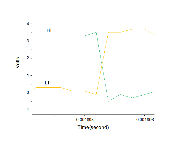

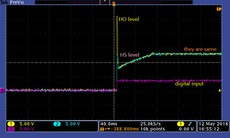

If I give a period rectangular wave that is HI and LI change from 0 to 1 periodicly. I find that the LO response is right. But the HO response is always the Vgate(Voltage on the FET’s gate pin) is equal to Vsource(voltage on source pin).My diagram is like this:
The yellow points represents test points. The red values are the tested values. I think this is UVLO fault. But I don’t know how to solve it.

    Notice HS make HO output very high during Cboot charge. It would seem HS is not being pulled to ground in start of bootstrap cycle?
    We posted similar captures this forum last few weeks, HS jumps to HO etc... The HO/LO (GTRon = 3R) may be a bit low value even @IGPK+/- 4 amp <10us pulse short to ground. This seems to stress HS during Cboot charge cycle. Cboot then remains mostly as floating voltage on HS -- after seems to leak output current onto Cboot forevermore.
    You mean to say the HI/LI are complementary PWM signals?

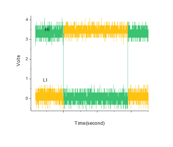

    It looks like your bootstrap cap, C5 isn’t getting charged. You need to drive HI and LO with a constant PWM signal, otherwise the bootstrap cap will get discharged due to the gate leakage of your mosfets. If you run it at 10-20 kHz, do you see this same issue?
  • I want to increase my input frequency but my device's bandwidth can't reach that range. I used a 300Hz PWM signal to try its performance and it failed again. Because the dropping time scale is shorter than 2ms. Could you give other scheme? Thanks!
  • Yes, when HI is high,and LI will be low.

    If you are using a function generator can it insert dead time periods between the HI/LI drive input times? If not the UCC2895 can generate signals you need, check the frequency range it allows.
    What does your waveform look like at 300 Hz?

  • BTW:
    After R7-R13 change 20k or remove per DON's suggestion when LO turns on HS pin should go to ground on scope capture. If HS only moves slightly down or half way from 13.6v when LO is above NFET gate threshold, the UCC is likely damaged. LO should pull HS or Cboot all the way or very close to ground prior to asserting the first HI drive pulse/s.

    The waveform is like this
    I have tried to remove the 2.2K resisitor and it works normally and the HO can maintian high within 60ms.
