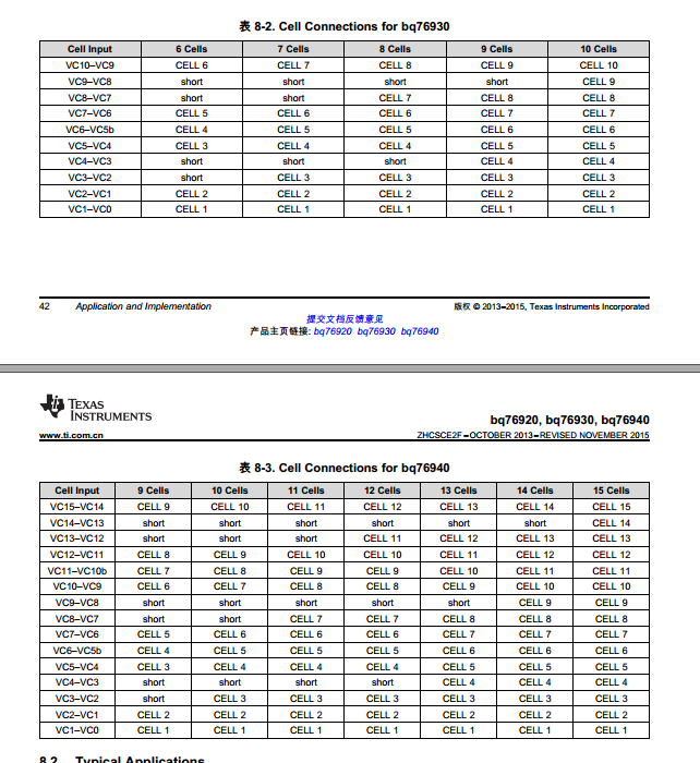

Hello TI Experts,
Now I am using BQ76930/BQ76940 for 16cells 20cells 25cells situation~
I have seen the Configuring Alternative Cell Counts  in the datasheet
My problem is that what solution will be better for 16cells 20cells 25cells situation?  two BQ76930 for 16cells & 20cells? two BQ76940 for 25cells?
If on the battery side,the distance is different betwen cells~
for example, when it's 20cells, cell6 and cell7's distance is much longer than cell7 and cell8, I want to short cell6 and  cell7 to reduce loss,Is it OK to do that? but it will be different from the cell  configuration according to the datasheet,
