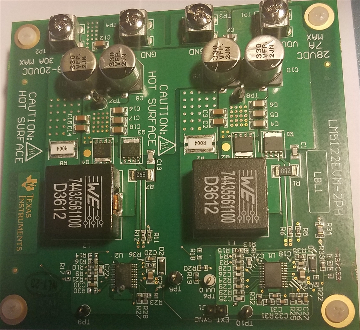

hi, bought eval lm5122evm-2ph.  2 phases, nice board.
very confusing about the many  0 ohm resistors.  pads are on the board, some resistors are on the board, all resistors are in schematic, but not on BOM.  strange.
I take that back, that is confusing.  R22, R23, R30, R37, R18  0 ohm resistors are not in BOM, but are in schematic, all have pads (??), and some populated on board.
same issue with missing D3 diode and C33 cap.
normally, I don't care about errors in docs.  but designing my own LM5122 2PH board is difficult.  don't know if a part should be included or not.  can someone fix erros asap?
I manually laid out  my pcb this weekend, then saw 10-16 parts are zero ohms.  that's huuuuge.  I'm not putting 0 ohm resistors down on my pcb.  what a waste of time, I should have caught that.
very alarming, is that populated C20 and R36 are reversed on the pcb.  this means the BST cap is not directly tied to BST pin--cap goes thru R36.  what is that all about?  don't say R36 is 0 ohms, what if a user changes the resistor--then all blows up?

  • Most 0 ohms are reserved positions so users can change to a different value if they want. For instance, you don't have to use a gate resistor, but we reserve a position so you can change to meet your performance requirement. Some 0 Ohms are actually jumpers used to configure the circuit. Users may want to slow down the gate drive to lower the EMI emission, but the drawback is reduced efficiency. You need to make trade offs in between based on your requirements.
    You can put MOSFET close to the IC, but it may not always be a case. As long as your gate and return traces are side by side, the MOSFET can be placed a further away. As you mentioned, being too close leaves not room for gate resistors, and leaving no option for your to change the drive speed. This doesn't mean it won't work or work worse. It just leaves no flexibility.
    Please not that the EVM is just an example and is optimized by the designer in his own opinion, which may not be perfect in others' opinion, but it works and works fine to its design spec.

    Regarding your traces, short distance is always good. Note that the LM5122 has 3A strong driver and it may be too strong to drive your FET directly. If I were you, I would reserve a gate resistor position in case it is needed. Without it, you lose the flexibility and may have to do another PCB layout. The 1.5Ohm may not be enough. If you really hate to put a zero ohm resistor, I would suggest you to replace the EVM MOSFETs with your selected MOSFETs, and run some test to see if the switching performance is okay without external Rg.

  •  pics for you.  now I notice D3 & D4 are unpopulated, on bottom.  terrible!  there's enough room on top.  I want to have schottky diodes on my design.  don't worry, I won't make the mistake TI did, I'll put them on top.
  • error--can only insert 1 file per reply, fix this. pics for you. now I notice D3 & D4 are unpopulated, on bottom. terrible! there's enough room on top. I want to have schottky diodes on my design. don't worry, I won't make the mistake TI did, I'll put them on top.
  • thank you for the picture. Let me get the clarification from you: I don't see R22, R23, R30 and R18 are populated. Have you removed these resistors from the original EVM?
  • please pay attention, I wrote they are missing from bom. that is terrible. I have not touched the eval board yet.
  • Okay, its clear now.  Thanks for the confirmation.
