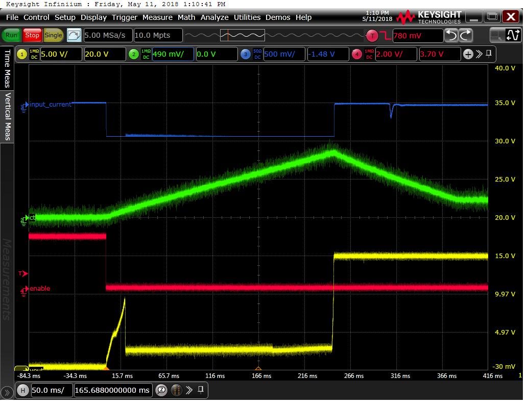

I have implemented a circuit similar to some of the other posts on this forum, with Rset = 49.9k for maximum current, and with a timing capacitance of 10uF for a fault time of 400ms. The device is implemented as a button controlled load switch. The button circuit is functioning properly, and is not causing any issue with enable control. The switch connects a lithium ion battery stack to a load consisting of voltage regulators and an additional downstream load.

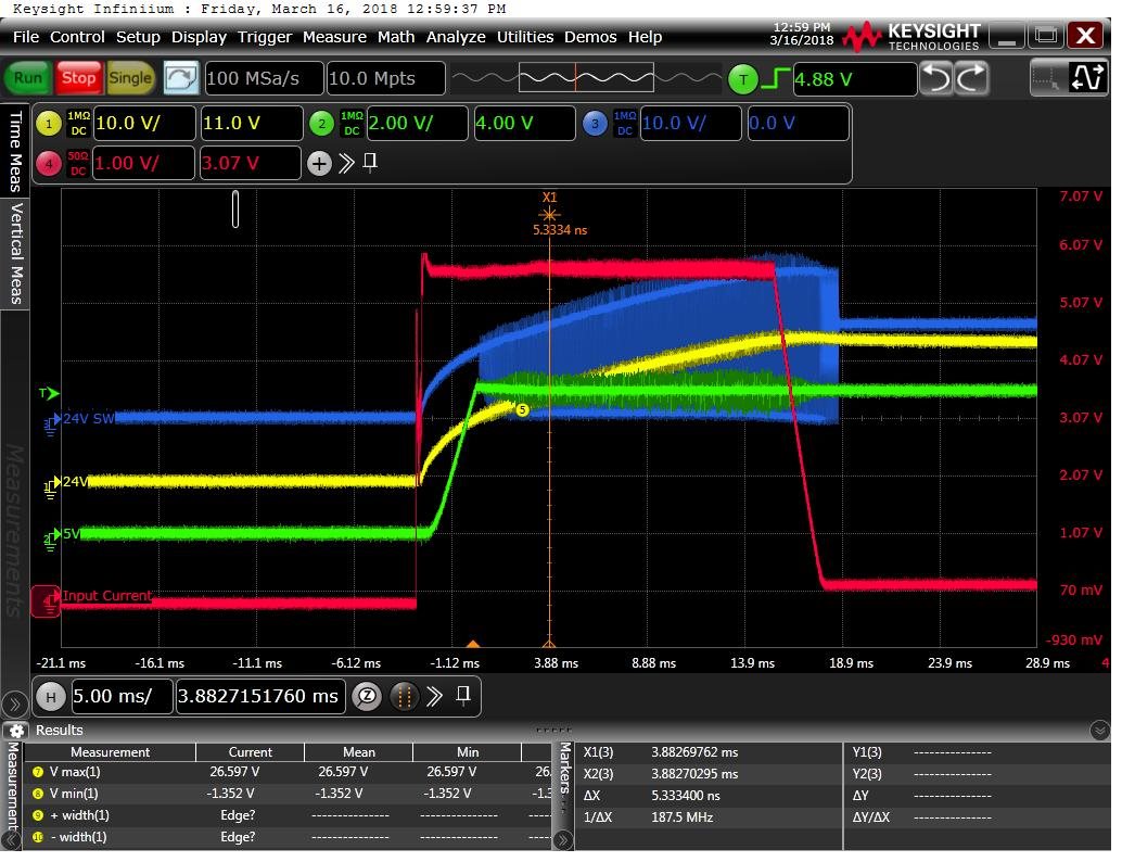

Before implementing the switch the load startup even was measured and characterized in the following plot. Note that the maximum inrush current is 5.5A at Vin = 16.8V, and the inrush even lasts about 20ms. Load current is the red waveform, and the others are voltages at the outputs of the regulators.
When implemented with the TPS2421, the circuit is not working. It appears something is internally limiting the output current to 700mA and tripping the fault timer. I have been unable to get the circuit to start up successfully with a load attached to the power supply, but if I remove the load and just start up the power supply, it successfully starts up. This can be seen below. Note that the below graph does NOT depict the fully loaded system.
The load that is not present in the plot above has a large capacitance (~4.5mF), that should be adequately charged at the rated current for this device. I selected this IC for this application because it is capable of handling large transient currents, so I am not sure why I am seeing this result. Even with the large capacitive load removed, the TPS2421 appears to be limiting the input current.

    Looks like it is violating startup load criteria as per "Section 8.4.2 Maximum Allowable Load to Ensure Successful Startup" mentioned in the datasheet. The device TPS2421 was designed targeting capacitive nature loads, where the device during startup operates in power limit mode (5W-typ) to manage large inrush currents and to protect the internal MOSFET against SOA related failures. If the equivalent load is more, the device will fail to startup.
    Please verify your design using tool available at www.ti.com/.../toolssoftware
    The below thread gives you more information
    e2e.ti.com/.../668601
    Please look into TPS25942A, TPS24751 as alternate options
