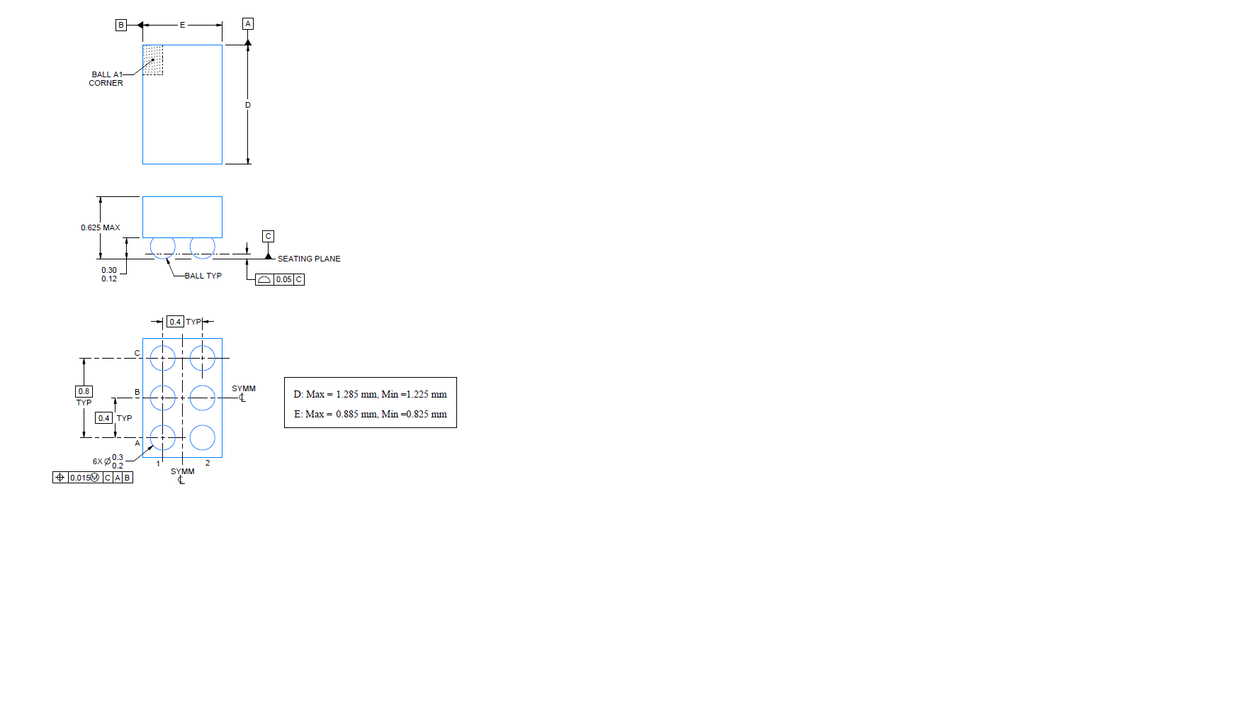

Hi Team,
LMG1020 pinmap and package outline in the datasheet do not look the same.
If see closely, package outline shows A1, B1, C1, so on,
Our pin shows 1~6.
Please kindly help to fix it, thanks.
Andrew
