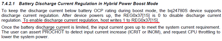

The datasheet shows the following in page 34.
>Internal discharge current limit is the lower one between the voltage set by DischargeCurrent(), and the voltage on ILIM pin.
Does EN_IDCHG_REG=0 disable the discharge current limit feature above?
I would like to know if discharge current limit set by ILIM pin is also disabled or not.
