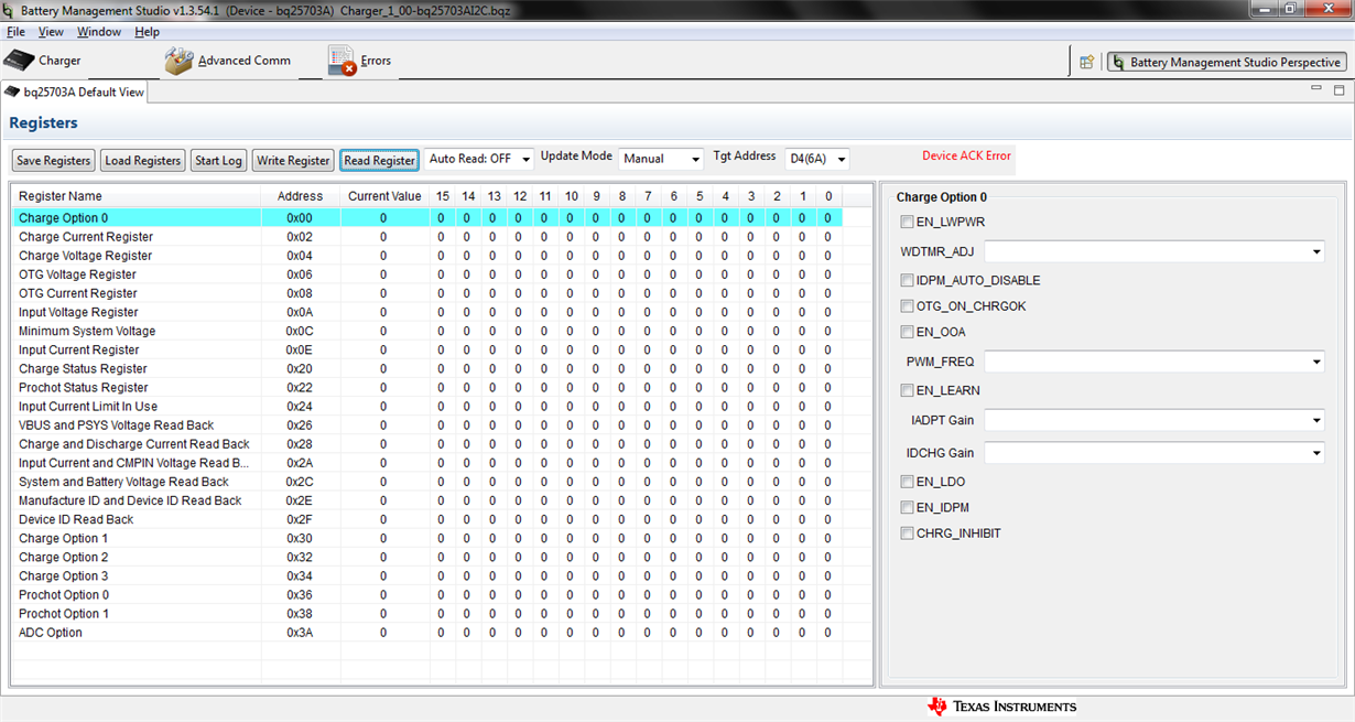

    But it still did not show in the list of supported targets. So i renamed the config file to "Charger_1_00-bq25703AI2C.bqz".
    Now it shows the BQ25703A as one of the supported targets. So now i move to next steps of changing “update mode” from “immediate” to “manual”. Upto this step it is done successfully.
    Now when i click on “Read Register” it shows me a "Device ACK Error". Attaching the screenshot of the same.
    Please help to resolve this issue.

  • Devendra Singh Solanki,
    Please change "Tgt address" from "D4(6A)" to "D6(6B)".
    If it still has trouble, please send me the SDA and SCL waveform.
  • Dear Wang Li,
    After changing the target address from "D4(6A)" to "D6(6B)", i clicked on “Read Register” it still shows me "Device ACK Error".
    I probed the SDA & SCL signals as per your suggestion,but they are at Logic High (i.e., 3.3V) for the whole duration while i select the target charger, change the target address & click on read register. Neither SCL nor SDA signal goes low.
    I tried using the Version 1.3.80 of BQStudio as well with same steps of copying new config file & changing target address. This also shows me the same "Device ACK Error".
    Is it possible that it needs EV2400 to configure the BQ25703A EVM. EV2300 cannot be used for this.
    Let me know your input on this.
    It is possible that computer OS needs EV2400 to configure the BQ25703A EVM. EV2300 may not be used for this computer.
    EV2300 may need to install the unofficial drivers for windows 64 bit. There is a forum post about this.
