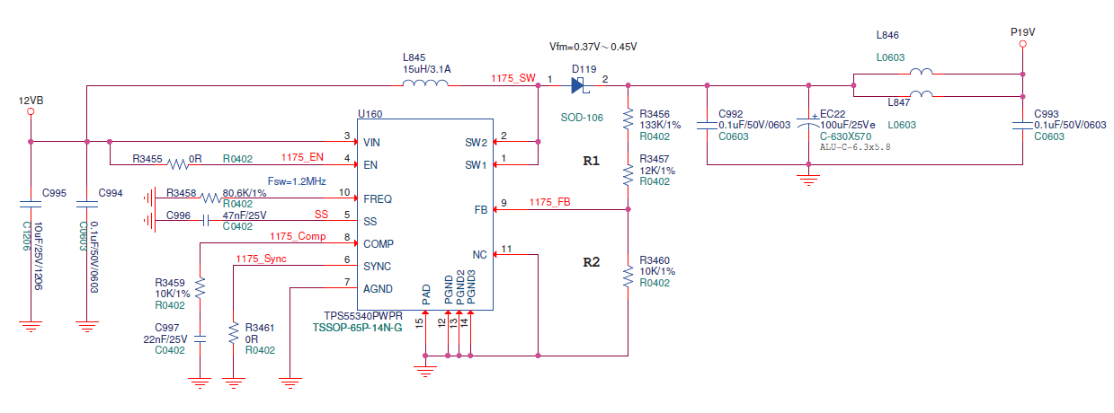

Dear E2E member,

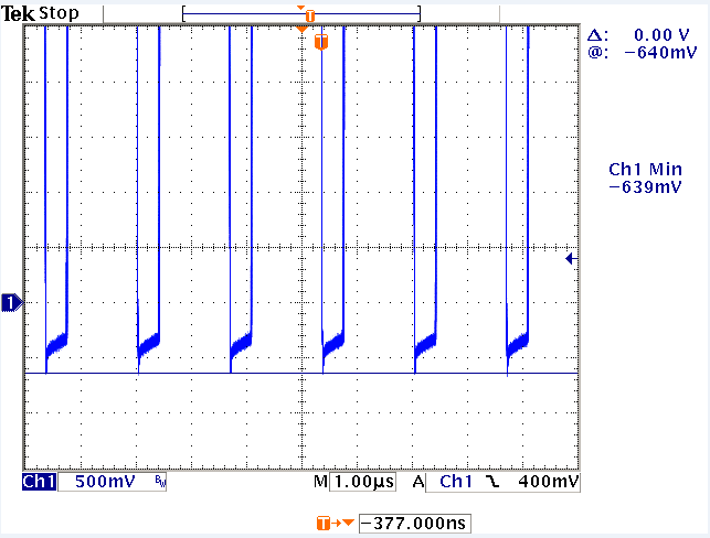

1. Our customer use TPS55340 and measure the SW pin, the undershoot is reach for -640mV.
Does it have any risk for this IC? The SPEC of IC which is -0.3V only.
2. If no risk,  Does TI have any technical document to confirm it?
3. If have risk, How can we improve from this design?
