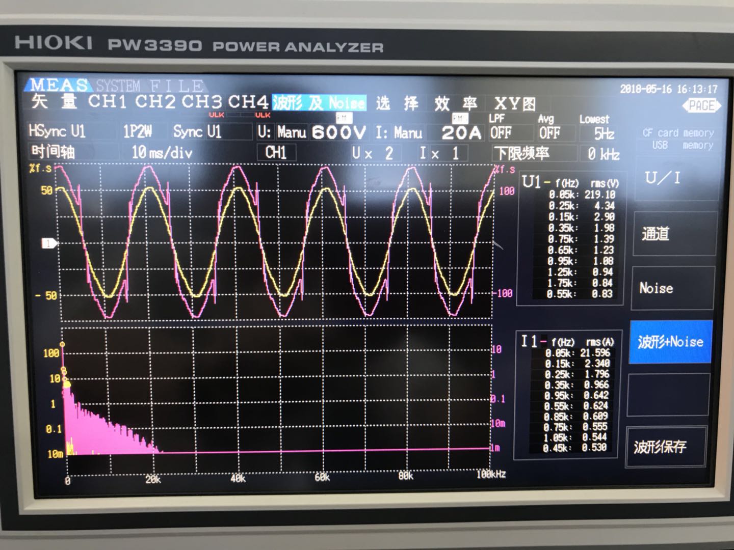

Dear Gentlmen:
         I am using UCC28070 to complete a 6.6KW OBC project,Output voltage is set to 403V,Frequency:100KHZ,Dmax:0.85,L=210uH
         When the input voltage is 220Vac and the output power exceeds 4400W, there will be a large spike in the input current. At this time, the PF will decrease sharply, and the waveform is shown in the figure. What is the reason?Test waveform.docx
    Your waveform shows the spikes around the zero crossing and I think it would be useful to get some more detailed waveforms.
    Can you get a scope shot showing the gate drive duty cycle, current amplifier output and the current amplifier input.
    The duty cycle is at its max value around the zero crossings and Dmax = 0.85 is a relatively low value.
    If the current amp were saturating you could expect to see some spikes here associated with the delay in the amp coming out of saturation
    So please
    (1) Take more detailed scope plots as described above
    (2) Try increasing the value of Dmax
    If you want to send me the schematic you can email johngriffin@ti.com and I will gladly review and provide more suggestions
    John

             According to your suggestion,I set the maximum duty cycle to 0.9 and, at the same time,I tested the IMO, VAO, and VINAC pin waveforms.Maybe You Are Right,According to my setup, the linear multiplier may have saturated, I tried to modify R88 to 17.4kohm, but the MOSFET break after hundreds of milliseconds without load, which is another problem.
             The problem is that the MOSFET is often damaged within a few hundred milliseconds after the run command is issued. Is there a timing requirement for the UCC28070 to power up or down?
              My machine is damaged and the waveform is sent to you later. Schematic diagram has been sent to your mailbox, please help review, thank you very much~
