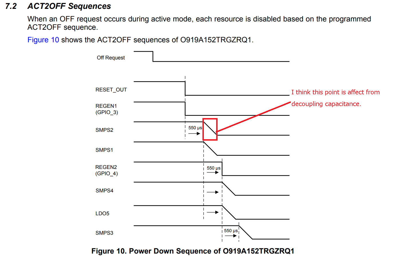

  • Nastasha san
    Thank you for your reply.
    I know, the outputs of the TPS65919 have a discharge resistor.
    I think the ramp down  of follow User's Guide (7.2 ACT2OFF Sequences) is affect from decoupling capacitance.
    Please let me know  if this understanding is wrong.
    Best regards.
    Hayashi
  • Nastasha san
    In other words, when the TDA 3x is light load, I want to know if the decoupling capacitor of the TPS 65919 has the possibility that the ramp down slows and deviates from the sequence.
    Although it is said that it is equipped with a discharge resistance, please check the above contents.

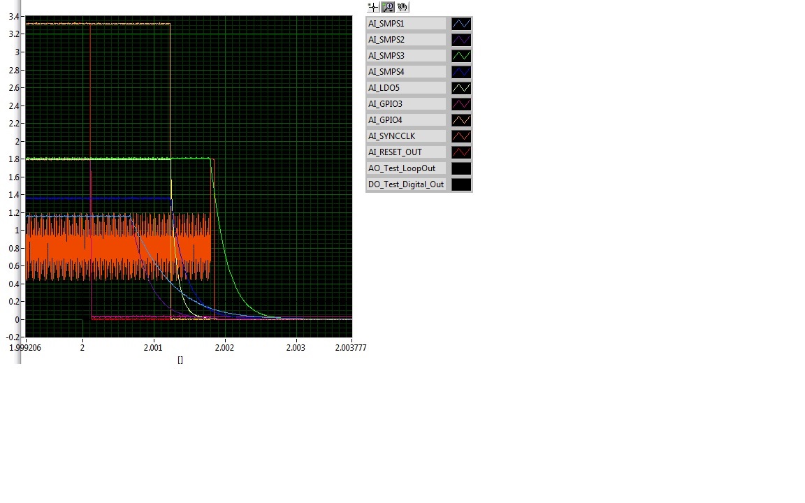

  • Hayashi-san,
    This is the data we took at no load. While it takes time to discharge, the sequence is still in the proper order. Additionally, the rails have discharged enough before the next rails begin ramping down. It is okay if the rail is not at 0V before the next rails turn off since it remains low. We have no concern here.
