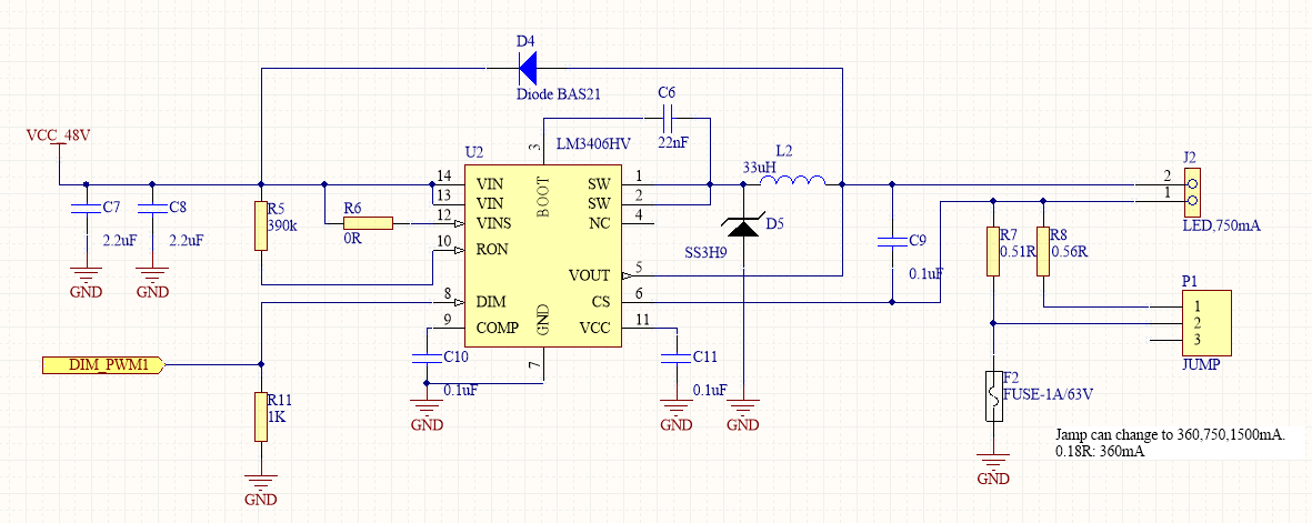

Hello, Everybody.
I designed LED Driver with LM3406HV, Input voltage 48V, the output voltage 45V, and out current 750mA
But this circuit doesn't work. it generates the output voltage 10V.
What's the mistake?
I hope someone teaches me.
Thank you.

The device can not increase the input voltage. and out voltage can be 35voltge.
The waveform is very disturbing.
In case of change the inductor with 68uH, out voltage was 15V.
perhaps. The circuit seems to be wrong.
