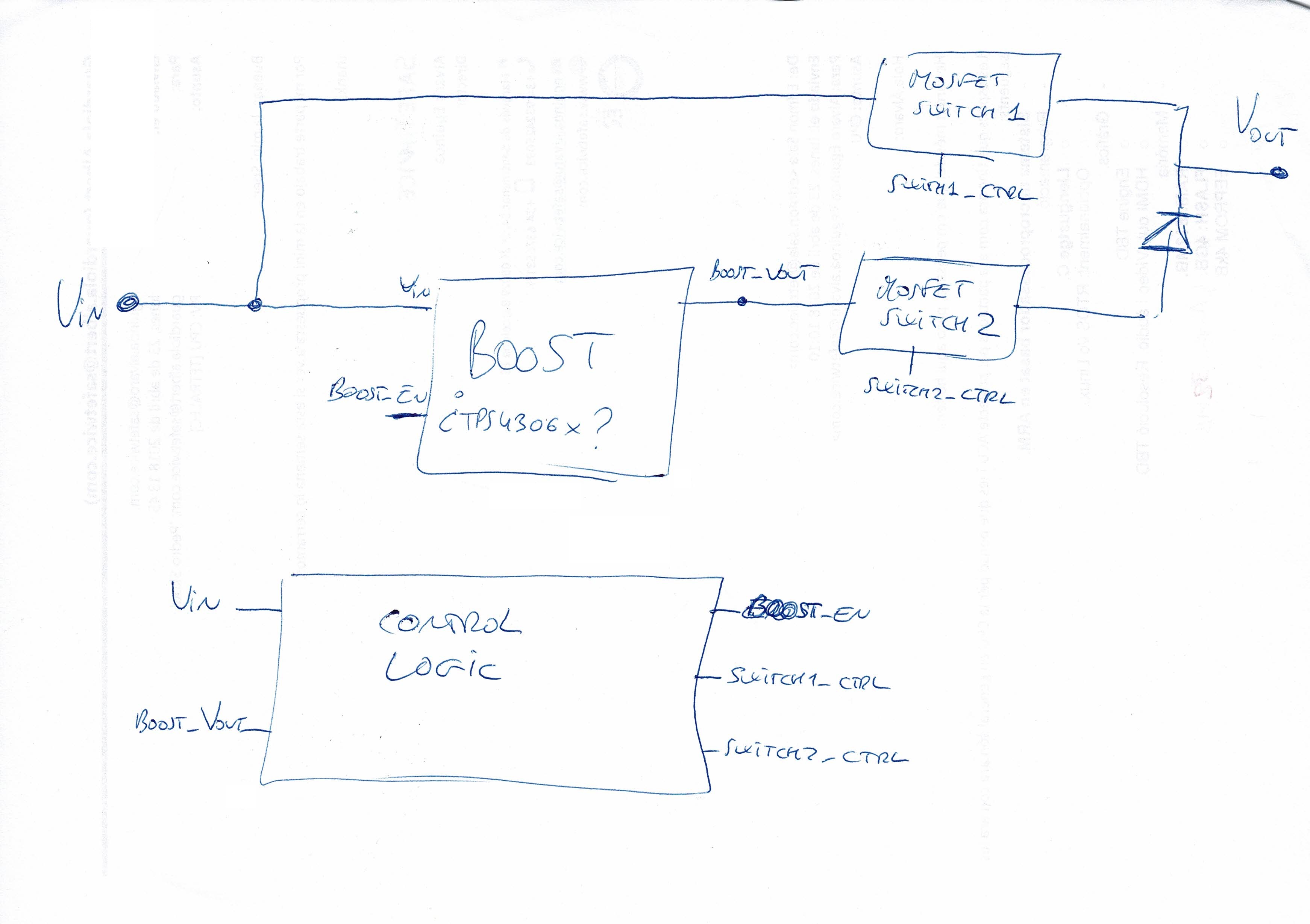

    Here i have come up with an "external bypass" arrangement, please let me know your view:
    -I am considering a controller such as TPS4306x that come swith an ENABLE pin (datasheet: tEN :EN to start switching time) 125 uF). Let's keep this in mind. This is the considered architecture:
    -Vin range goes from 6V to 12V, nominal is 12V, that is above 11.7V, which is the lower threshold to enable bypassing. So nominally, the device is in bypass mode.
    -A transient occurs (automotive motor crank) and Vin goes down from 12V to 6V in 6 ms and stays there for about 1 s.
    -Below Vin=11.7V, the device must shift to boost mode, and Vout target must be set to 13.2 as specified (see my first post).
    -A simple control logic would be enough to turn SWITCH1 off and SWITCH2 on properly so Vout is hold. The problem is commutation time.
    -So here's the proposed control for a two-step shift to boost mode.
    1.When Vin drops below the Vin threshold, BOOST circuitry is enabled (BOOST_EN=1) but SWITCH1_CTRL remains on and SWITCH2_CTROL remains off.
    2.When Vout reached target BOOST_VOUT, Vout is switched to BOOST: SWITCH1_CTRL goes oof and SWITCH2_CTRL goes on.
    What am I concerned about? That the two-step shift to BOOST mode implies that
    1.First, the BOOST starts switching with no load.
    2.Then, when target BOOST_VOUT is reached, a 10A load is connected to the BOOST. How will the regulation work?
    Please make your comments. And let's hope you come up with a more built-insolution (perhaps using LM5122 as initially considered).

    I still have not come up with a good way to meet the 10us response requirement. The approach described using the switches might have a hard time meeting this requirement as well.
    Can you explain why you need to higher voltage requirement during cold crank. Typically in this application the boost converter is just there to keep the voltage above something like 10V.
    -Garrett

  • Albert,
    The concern is how fast the from sensing the input voltage changed to turning on the switch to power from the boost converter. It depends on how the voltage levels are being sense. If a micro-controller is being used it might be hard to meet the requirement.
    There will probably be a dip on the output voltage (13.2) when the switch is turned on for two reasons. The response of the TPS40360 since it operates in DCM at no load. The other being the load is 10A. Adding extra output capacitance will help to reduce this dip.
    Garrett
