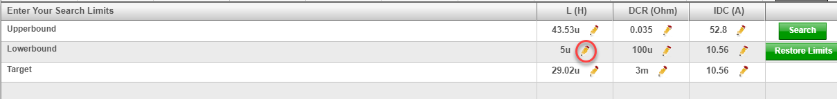

  • Hi Vern,
    To find inductors that are not in the recommended range, you can try clicking on the pencil symbol in the select alternate parts window-> changing the lowerbound value and then clicking search. This should give the inductors in the lower range that is expected. Again, when you are outside the recommended range, the stability and other performance parameters of the design has to be thoroughly verified by you using simulations to to have confidence that the design works as expected. But the tool will give you flexibility to pick other components in our database if you decide to do so instead of creating custom components for each design.

  • hi, if you don't mind continuing with these inductor values. please.
    I do get a warning about instability.
    once I pick my custom 22uH inductor, no other parts ever show.
    but after seeing many software issues with webench, I have no faith.
    I will have to look into instability, but if not webench, what to use?
