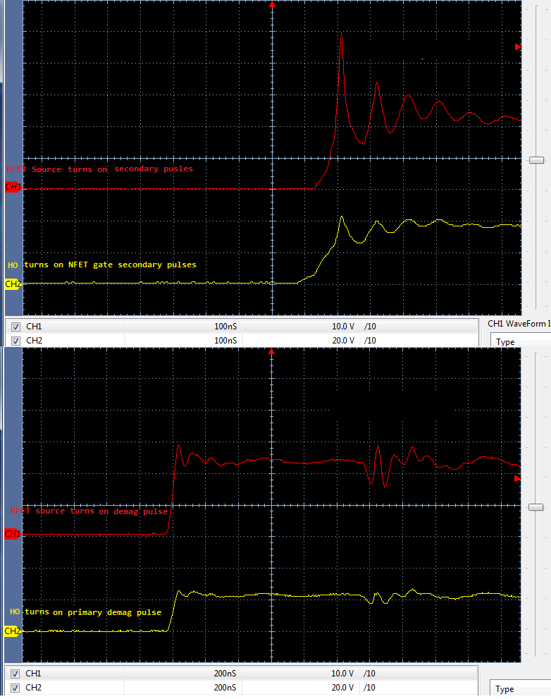

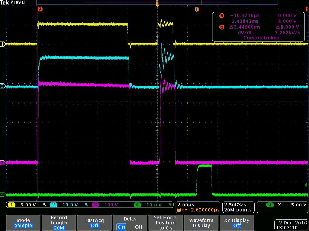

We capture certain position of LO ring ghost or follow HO ring and or undershoot may be HI/LI driven cause? We notice 140ns 1/2 bridge dead band delay make HO incorrectly produce 140ns positive pulse when it should be delay time only. If we make 100ns delay the HO pulses diminish into a minimal sine wave when HO transitions from high to low but not entirely in every case. The Gton=530ma and GtOff=1.5amp yet we have never heard of Toff switch node ringing or odd HO/LO ghosting captures show below. Especially when inverted LO is producing short HO pulses between the main trapezoidal waveforms. Only HI is inverted and derived from LI during delay periods but only for a previous high to low transition of HO in any current output period does a delay occur.
Perhaps UCC shorter Tfall 30ns, 125ns propagation delay and faster NFET Toff 24ns delay, 8ns fall time allow even shorter dead band period than 100ns? How minimal can 1/2 bridge dead time delay be made when NFET Trr is 144ns Nom to 288ns Max? Can some HI/LI dead band generator phasing be causing random pulses in the HO period but only when LO high to low?
Updated capture below after bravely setting dead band generator 60-80ns. Most documents suggest dead band delay be set 1.5 - 2 times the minimum pulse width. So 0.8us (800ns) minimum pulse width makes dead band delay 1.2us but not 80ns. Perhaps the PWM generators minimum pulse width is set to high in software algorithm!
  • Hi BP101,
    For your scope shot showing "LO pulses make HO ghost pulses" how are you measuring HO? Are you using a differential probe? If not, where is the ground for the oscilloscope probe?
    And, is LO really high for 3.5 ms? That seems like a long time.
  • Hi Don,
    I think your missing the bigger point to determine why HO follow LO undershoot. In that aspect does it really matter HO ground is common. The PWM frequency 12.5Khz(80us) period, LO pulses are near 100% duty (79.85us) indicating high side NFET in slow decay. Slow decay artifact can be seen as LO pulse reach near NFET Ton 4.6v threshold, LO side NFET is mostly saturated, HO is switched for speed control duty cycles. Welcome to slow decay mode, produces power from inductive recirculating current in HO side NFETS.
    The question is how short can dead delay be safely made given added delay of gate driver and NFET Toff fall/delay time. Do we subtract gate driver added delays or add it to dead band period? When we add gate driver delays to NFET Toff fall time/delay, gate driver produces artifacts of (excessive) undershoot condition. Undershoot drives DC Bus Voltage upward as a result, shorter dead delay trimmed 18vdc off inductive voltage rise and reduced most of HO undershoot but not all.
    Slow Decay:
  • Perhaps there is a hidden timing problem between HI/LI as partially proven by reducing dead band delay period, HO undershoot is significantly reduced!
    The capture of LO you question 3.5ms (yellow square) is 60 degrees PWM window of many 80us periods where software controlled dead band delay occurs prior to each new/next period. Those HO undershoot pulses -6v or more at times are not UCC killers but should not be produced at all in slow decay. Only fast decay produces pulses from ground up to HO rail in that same (yellow square) area.
    The question is how to stop remaining HO undershoot as the LO side is not for this 1/2 bridge HO inductor leg (captured) but another gate drivers HO leg. LO was scope trigger source most captures above. It seems the HO undershoot pulses are occurring from UCC internal creepage or MCU HI/LI timing is not sharp enough for UCC. The VDD pin has 10uf to digital ground trace and common pin 1uf to analog ground plane provided by low side NFET from VIA to analog ground plane under side of PCB. Past other vendors gate driver we tested similar filter (HI/LI 100R/200pf) produced excessive rising edge roll off. UCC rising edge seems ok with 51R1/200pf but have you noticed any HI roll off cause any issues with HO drive relative LO?

  • Hi Derek,
    Derek Payne said:
    The second is a function of how much current remains in the body diode when the other conducting MOSFET is reactivated, and that reverse recovery spike can be very nasty
    Albeit HO is simply switching on the gate when the voltage spike occurs NFET source, so that is not diode Trr until HO switches off in dead bands well before LO copartner. What we are seeing is the effect of Totem pole oscillating from over driving NFET gate after Miller plateau has been reached, no pause. Agree the HO slew rate is far to fast thus seems to cause random overshoot just above Miller region. So source perhaps develops excessive number of holes ride on HS, seen as magnitude increases in the ringing effect.
    Perhaps protection 20k resistor across HO/HS pins fails to clamp faster source depletion holes entering HS pin, back out HO as aggravate inductive ringing spikes. Voltage magnitude grows uncontrolled in first pulse relative to charge pump floating voltage conditions at that time. The kind of info lacking in datasheets or other PDF documents, thus we need help to determine how UCC over other vendors gate driver is randomly increasing gate drive current (after Miller) as the switch peak is being reached only during HO turn on state. Hard to imagine 16.5v zener diodes placed across HO/HS may aggravate inductive ringing, mostly HO rings not so much at all LO. Again some ring is ok but the voltage peaks HO produce in NFET source are far to high for safe operation when approaching BVRdss.  That never occurred in slower gate drivers coupled with even slower Trr.
    BTW above link below posted PDF, Infineon OPTIMOS-FD (fast diode) has 20% faster Trr than our previous HEXFET slower Trr,  was producing less source ring magnitude with much slower gate driver. We never saw turn on peaks exceed +10v of drain voltage with a local DC bus voltage cap (470uf) and now two 680uf parallel 1360uf low ESR rated 1.9 amp ripple voltage. So surprised 24vdc HO randomly was producing over 90v lastly up to 50v switch turn on peaks (HO/75R) in the first ring pulse. Ideally if the UCC HO/LO slew rates are to fast we better slow down HI/LI slew rates? Documents suggest to increase HI/LI slew rates, perhaps faster is not always better?
    How does HB/HS relate to HO in current drive aspect when NFET source holes enter HS relative to chosen external resistance values?

  • BP101,
    Am I correct in understanding that you are testing with a 24V bus, and you are driving 200V FETs? Most MOSFETs are designed to be operated between 50% to 70% of their rated voltage if used for switching, and there will be significant ringing at lower voltages due to the changing parasitic capacitance of the MOSFET across voltage. See the graphic below. When switching in the red region, the change in capacitance will cause substantial ringing; when switching in the blue region, the parasitic capacitance has settled to a rough final value, and the ringing will be substantially reduced.
    We see this effect all the time when using UCC27714 to drive 600V MOSFETs with system bus voltages of around 100V-150V. Consider the following double pulse test, where CH1 is HI, CH2 is HO, CH3 is HS, and CH4 is LO. The inductive load is tied from HS to GND. The bus voltage is set to 100V. Note that the dv/dt of the transient is over 150V/ns, and operating so far outside of the driver's absolute maximum ratings is causing missing pulses on the driver output:
    There is 300V of switch node ringing. Below is the exact same circuit at 400V bus voltage:
    There is about 50V of switch node ringing, and it is reverse-recovery related. The initial pulse, with no reverse recovery, has barely 20V of ringing.
    How does your system behave when your chosen MOSFET is switched at its target bus voltage?
  • Hi Derek,
    Thanks for investigating this issue and taking the time to understand what is going on in this case issue.
    Sadly the problem gets worse with higher VDSS well above 24v, the inductor Q should drop as voltage is increased. Our case the load into HS is not tied to ground rather HS of copartner 1/2 bridge. Even though LO is high in that same 1/2 bridge, HS is exposed but clamped off to HO. Yet Cboot is charged during this same time according to Infineon documents.
    Please lets end this thread getting long as 80v VDSS typically produces in excess of 138-142 volt peaks posted in other thread. Again it's not the ringing being directly the problem it is the result that occurs in the secondary pulse amplitudes exceeding well beyond VDSS. That alone becomes a major problem as monitored bus voltage is easily tripped unless set well above a safety level, 10-20v above VDSS. So at 165VDSS we would have to set the safety monitor above NFET's BVRdss 200v. The high peaks also lead to MCU issues in the ADC samples being compromised from FB. That will never fly....
    As explained we past used other 600v gate drivers that did not produce uncontrolled voltage peaks, even at 24vdc. The UCC HO output is not limiting drive current by only a resistor, may be part of the problem, perhaps not entirely. For example we tested the same inverter up to 192VDSS with 250VBRdss NFETS without tripping the safety monitor set 5v above. Course inductors cause VDSS to quickly fall off but the point is the ringing peaks never exceed much above VDSS.

    Notice our secondary pulse is not Trr recovery related, it is the next 80us HO on time and diode recovery is occurring relative to HS near ground not above HS as shown in your captures.
    In my opinion that ringing in our capture shown on the secondary pulse is not Trr recovery as the gate or DS are never switched off, negating Trr recovery in that time frame. How could HO NFET body diode enter reverse recovery when DS are near VDSS thus making it reverse biased in our capture. The secondary pulse in our capture is result of inductive current flow via DS causing said ring.
