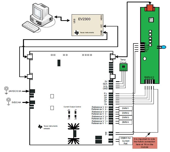

    These are the instructions for connection,
    Instructions for setup
    Power up the board connecting the 24V and 5V PSU to their terminals, (+24V, 24V RTN) and (+5V, 5V RTN)
    Use separate grounds for both power sources, should be set individually
    Connect an ev2300 to the i2c and smbus terminals near the power terminals, then connect it to the computer
    Connect the cell (4 pack) to the cell-, cell1, cell2, cell3, cell4 terminals
    Short the bat - and cell- terminals
    Jump the pack- and bat- terminals
    Short pack+ with pack+ on the evm
    Short pack- with pack- on the evm
    Connect the smbus cable between the evm and the mtester on the cell terminals side of the board
    Set power to 24V and 5V with a tolerance of 2A or 1A on the PSU
  • I am following your instructions, and have not gotten any different results from those I described before. My setup is wired up like this diagram from the Advanced bqMTester manual:

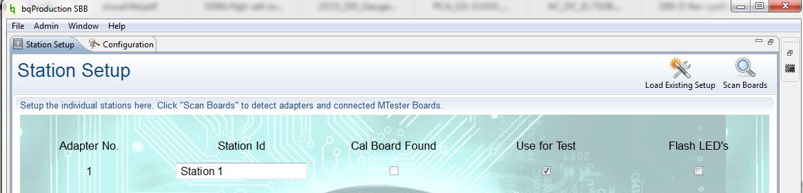

    Here is a screenshot of the connection detection screen in bqProduction:
    I have observed the following:
    1:  The Pack+ and the cell power on the BQMtester never come on, so the BQ40Z60 on the external board never gets powered on.
    2:  When bqProduction is running, I never see any activity at all on the SMBus (or I2C) lines.  The SMBus data and clock lines are pulled up to 3.3V.  I assume that the power on the bqTester is supposed to be enabled through either SMBus or I2C communications that come from BQProduction, through the EV2300.
    3: I know that the EV2300 and the BQ40Z60 board work because I can use them with BQStudio.
    Why isn't the EV2300 outputting any communications when I am running bqProduction?
