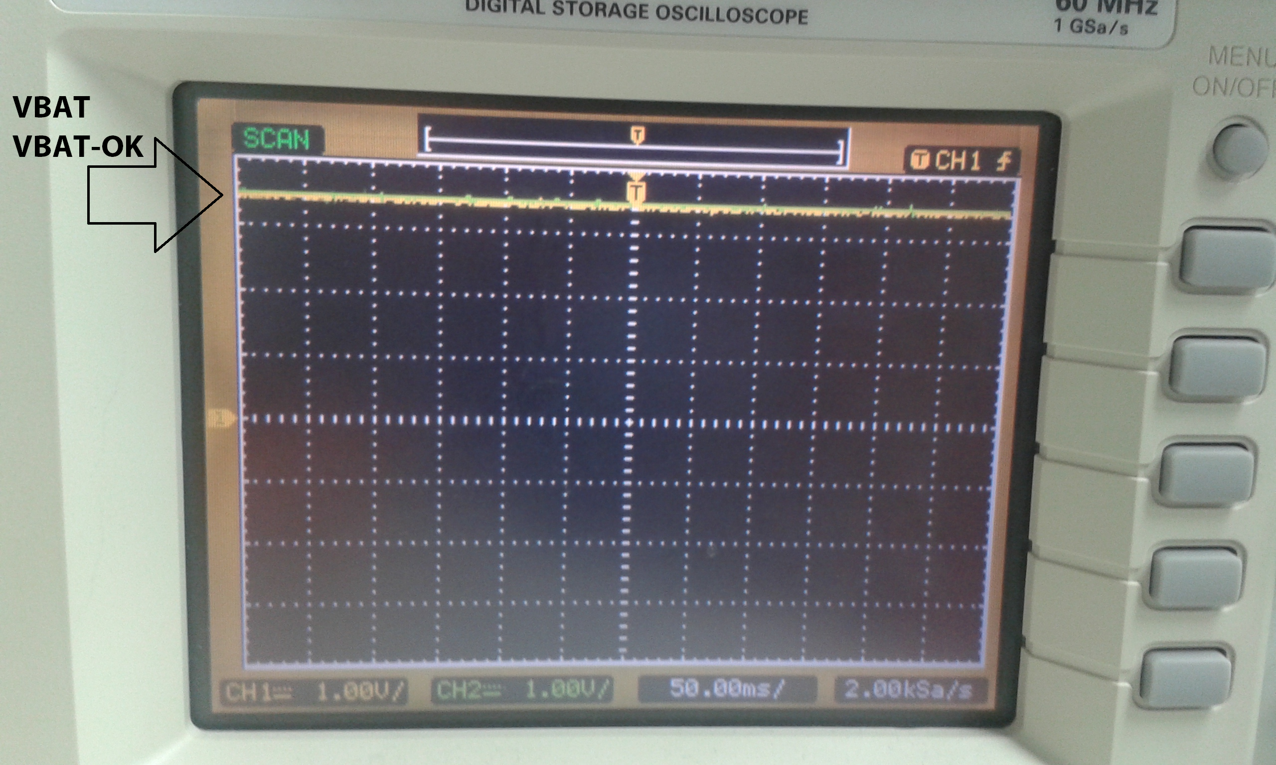

I am using a thermoelectric generator to provide energy to run data recording on a microcontroller. I am using bq25504EVM as a power management board. I want to set it up in a way that microcontroller turn on only if BAT-OK is high. I change the voltage of BAT-OK to 3.3V so I can connect it to a microcontroller. The problem is the microcontroller is ok during sleep (4micro amp, 3.3V) but during the time that it is active the voltage of BAT-OK is changed to 1.2V instead of 3.3V. What is the current limitation on BAT-OK? I am drawing 50mA at 3.3V when the microcontroller is active.

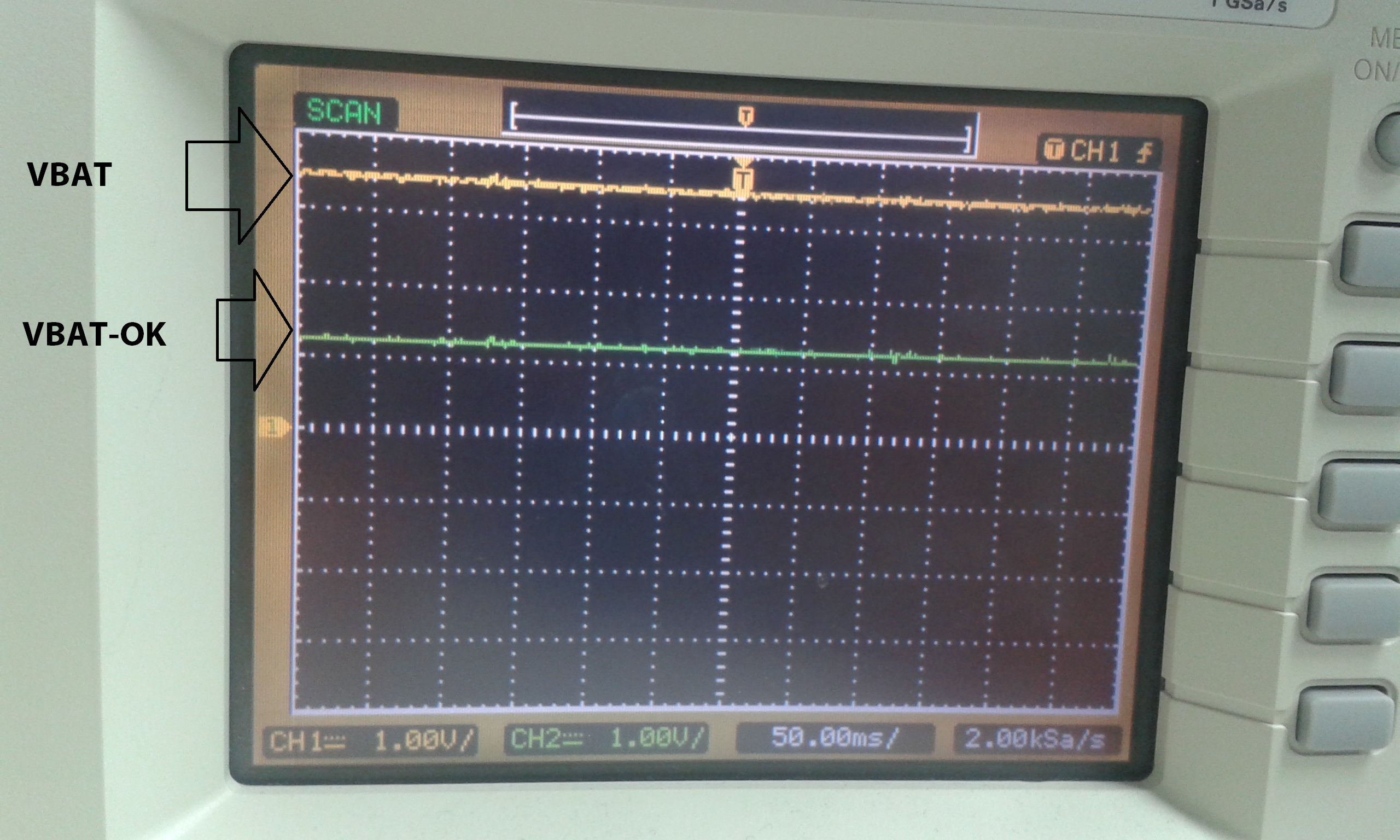

    Also, can you provide me with a scope capture of VBAT, VSTOR, and VBAT_OK? Thank you very much.
  • Thanks for your reply, I have a fully charged capacitor connected to VBAT. Fig 2 shows the VBAT and VBAT-OK are charged and high value. Then when I connect the microcontroller to the VBAT-OK the voltage drops like Fig1. Other configurations are shown in Fig 3.
    I know the microcontroller draws 50mA at 3.3V.
    If I connect the microcontroller to Vstor everything is fine and it works but then I like to use VBAT-OK to keep the microcontroller off when there is no enough energy,

    The VBAT_OK signal is used to indicate turning on and off system load on the VSTOR pin. I don't think you can connect the load to VBAT_OK pin, you can program turn on and off the system load connected on VSTOR pin by programming the VBAT_OK_HYST and VBAT_OK values.
