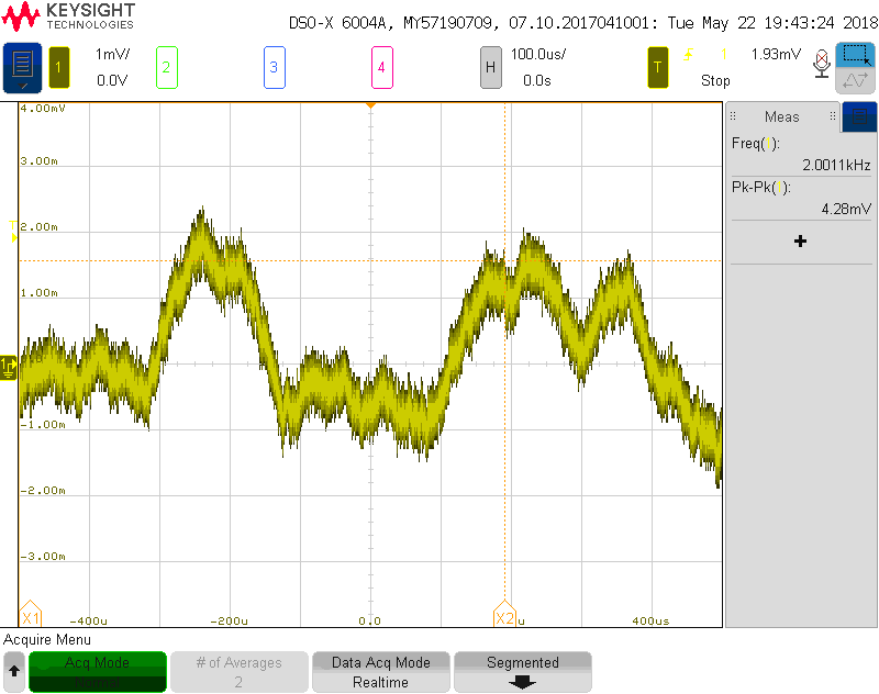

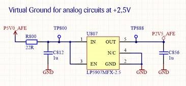

my customer is experiencing some phenomenon with a LP5907MFX-2.5. There is almost no DC load only some OPAMPs are connected a schematic is posted below:
The requirement is that the 2.5 V are extremely quiet, especially harmonic signals of the sound spectrum should be avoided on the output. The customer is now experiencing some noise - artifacts of the used signal - on the 2.5 V output but only about 10 % of the LP5907MFX-2.5 show this behavior. The noise is in the region of 2 mVpp … 8 mVpp what is to high already.
The customer can not identify what in this 10% of cases triggers this event. The LP5907 itself, passive components or the OPAMP
At one board exchanging the LP5097 solved the problem, another board did not show any improvements after changing it.

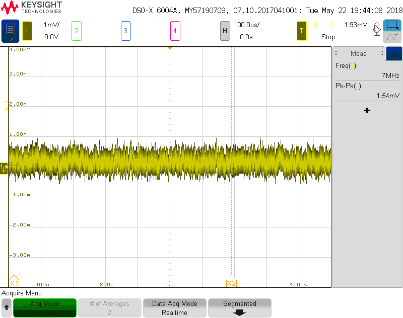

What definitively solved the problem is to force a small DC current of 1 mA by adding a load resistor. Now since the load regulation is speced from 1 mA the customer concludes this might be the explanation.
2.5 V without  load
2.5 V with 1 mA load

  • Hello colleagues,
    thanks for the quick response.
    The output cap is a Murata GRM188R71C105KA12D that has been carefully selected to maintain the LP5907's minimum requirement of .5µF under worst-case conditions. With the cap at minimum tolerance, DC-bias, ... it should never fall below .75µF. This also cannot be the explanation for the failing units, since the measured capacitances of the good and the bad units show no difference.
    We have tried varying the output capacitance using an additional ceramic cap of different magnitudes up to 47µF. At around 10µF we could observe a sawthooth-like periodic ripple of ~4mVpp at the LDO output, clearly caused by the LP5907 itself.
    Ignore the spikes in the oscillograph above - i used a long grund-tap at the probe to get my hands free.
    The base frequency of this oscillation decreases with rising output capacitance. So we decided to stay significantly lower than 10µF.
    An output capacitor in the range between 1µF...10µF did not held to suppress the signal artifacs as shown in the first picture.
    To clarify this: I am sure, that the problem here is not the oscillation of the LP5907. I can clearly recognize my signal waveforms on the 2V5 rail.
    There is a 100pF-coupled connection from the signal path to the P2V5-rail and i assume this is also the magnitude of the overall couplig capacitance from the signal path to 2V5.. The capacitive voltage divider 100pF/output-cap theoretically gives more than -80dB attenuation of the signal in the 2V5-rail.
    Adding another 2k2-Resistor in parallel to the output cap doesent explain the significant improvement shown in the second oscillograph.

    Maybe too low an ESR of the output capacitor is the problem here.There are 4 more 10nF caps in this net giving a pretty wideband low-Z shortcut in combination with the 1µF output cap.

  • Hello Kyle,
    of course! The LP5907 has no push-pull output. The additional burden discharges the output fast enough to keep the LDO regulating. *facepalm* :-)

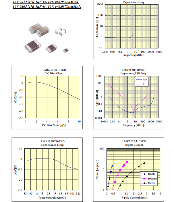

  • Hi Jens,
    it's always difficult to analyze a circuit without having a schematic...
    Taiyo Yuden has detailed datasheet which shows the ESR:
    Open the specsheet in the right of the page:
    Samsung has also nice datasheets.
    Take this ESR issue seriously. Adding a load resistor with so little impact on the load current will hardly cure a too low ESR. But you can easily add some resistance in series to the ceramic cap to imitate a higher ESR. I do this all the time in out circuits. Then even paralleling ceramics is fun.

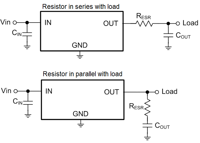

  • Hi Jens,
    No, adding the resistive load to account for a lack of ESR in Cout is not recommended as these two things are addressing separate problems. The cap ESR is addressing stability and your added resistive load is helping your application to discharge the noise coupling above your nominal output voltage.
    Regarding ESR, murata actually has a good web tool for seeing the characteristics (impedance, ESR, voltage derating, etc...) of their caps and it has many GRM-series caps. You can find the ceramic caps here
    If the capacitor's ESR is too little then what is needed is an added resistor between the Vout pin and the output cap. There are two ways of doing this, adding a resistor so all the load current flows through that resistor (in series with the load) or adding a resistor so only the currently flowing into/out of the capacitor flows through that resistor (in parallel with the load).
    The series configuration works well for applications that have low load currents, multiple capacitors connected to Vout, or those which will have fast load transients. The series configuration doesn't limit the capacitor's ability to provide current during a load transient.
    The parallel configuration works well for applications that have high load currents, minimal number of capacitors connect to Vout, or those that don't have stringent load transient requirements. The parallel configuration doesn't cause an I*R drop which can be problematic for higher loads.
  • Hello guys,
    to conclude this thread:
    1.) The problem has been caused by the fact, that a capacitive coupling for an audio frequency signal onto the output of the linear regulator is present. Combined with a practically non-existent DC load, this lead measurable  to a signal remains at the LDO's output, since the LDO is not able to sink current and lower its output voltage under regulation. Adding an additional burden helps to discharge the output caps and keep the LDO in regulation. In this configuration we do not see any signal remains at the LDO's output rail, the noise behaviour is satisfying and we do not see any hints of instability.
