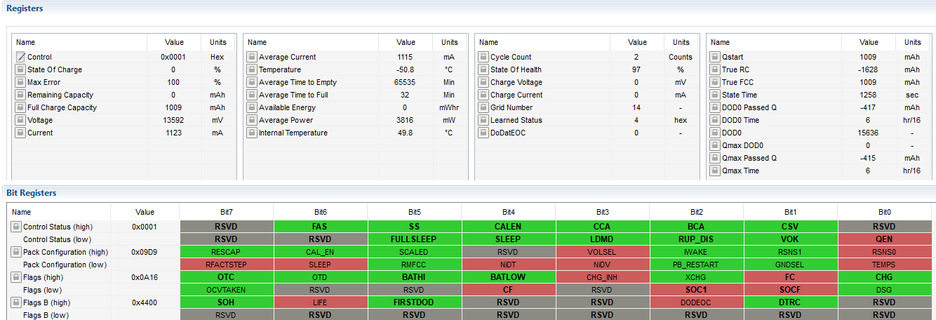

  • I ran 2 charge/discharge cycles with a light bulb draining 400mA, and the gauge seems to display the correct drain/charge current and voltage.
    However, it looks like it hasn't learned the battery's properties. I sent "IT_ENABLE" before running these test, but the full charge capacity is displayed as 1 Ah (for the 3.2Ah battery).
    The following readout is from when the battery was completely drained, and plugged in for 10 minutes or so.
    Do I need to perform any additional settings? Does the gauge save it's state to it's internal flash automatically? (because the average values are reset every time)
    The temperature does not seem to be calibrated correctly (-50°C vs 48°C, when room temperature is around 26°C, measured with infrared thermometer on the pack).
    When the documentation says to let the battery relax, am I supposed to disconnect it completely, or do I need to leave the system on (with 47mA nominal drain)?
    William
  • Hi William,
    How long did you let the cell rest after full charge?
    How long did you let the cell reset after the full discharge?
    If the cell does not rest, Qmax will not update.
    Please repeat the test, but fully charge the battery and then remove the battery from the charger with no load and allow it to rest for at least 5 hours.
    If this is an LFP cell, please make sure that full charge termination has been met (or the device will require up to 48 hours of reset after a partial charge).
    Discharge the cell to empty and allow the cell to rest again for 5 hours.
    This can be performed out of the system and with the EVM.
    For better temperature readings, please use an external thermistor and set the device for external thermistor usage in the configuration register.
