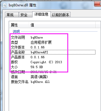

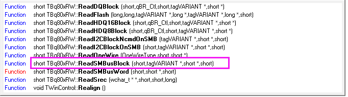

  • Why is my ReadSMBusBlock function parameter different?
