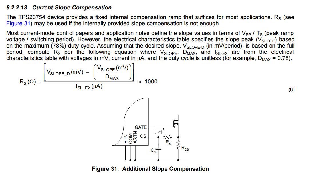

TPS23756: hy we need the external the slope compensation and when we need to add the external slope compensation.
Part Number: TPS23756
Hi team,
My customer is using the TPS23756 now. They want to check why we need the external the slope compensation and when we need to add the external slope compensation. From the datasheet, we can get some ideas, could you please explain more about it? Thanks.
