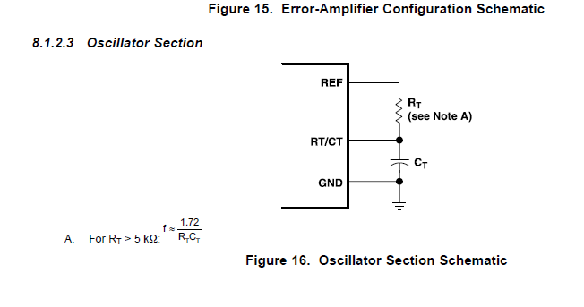

Dears
We can find the calculate way when RT>5k,but I can't find the calculate way when RT≤5k
Could you help to tell us how to calculate the frequency when RT≤5K。
