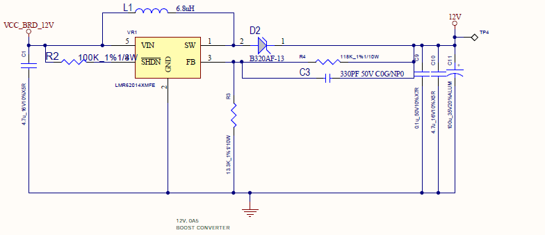

LMR62014: 12v input is possible for output also 12v.
Part Number: LMR62014
Now i am using in my design battery as well  12vdc which is generated from AC supply. Both are in oring circuit. Any one will come as input in board.
My question is can I use LMR62014XMFE in which output voltage is  12 V fixed and input voltage 12V (when AC supply is there in my board) and 8.4V (when AC is off , MY board is working on battery)? LOAD current is 0.5A.
Please let me know input 12V and output is 12V,  possible to work?
